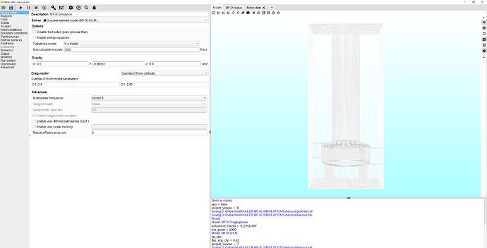

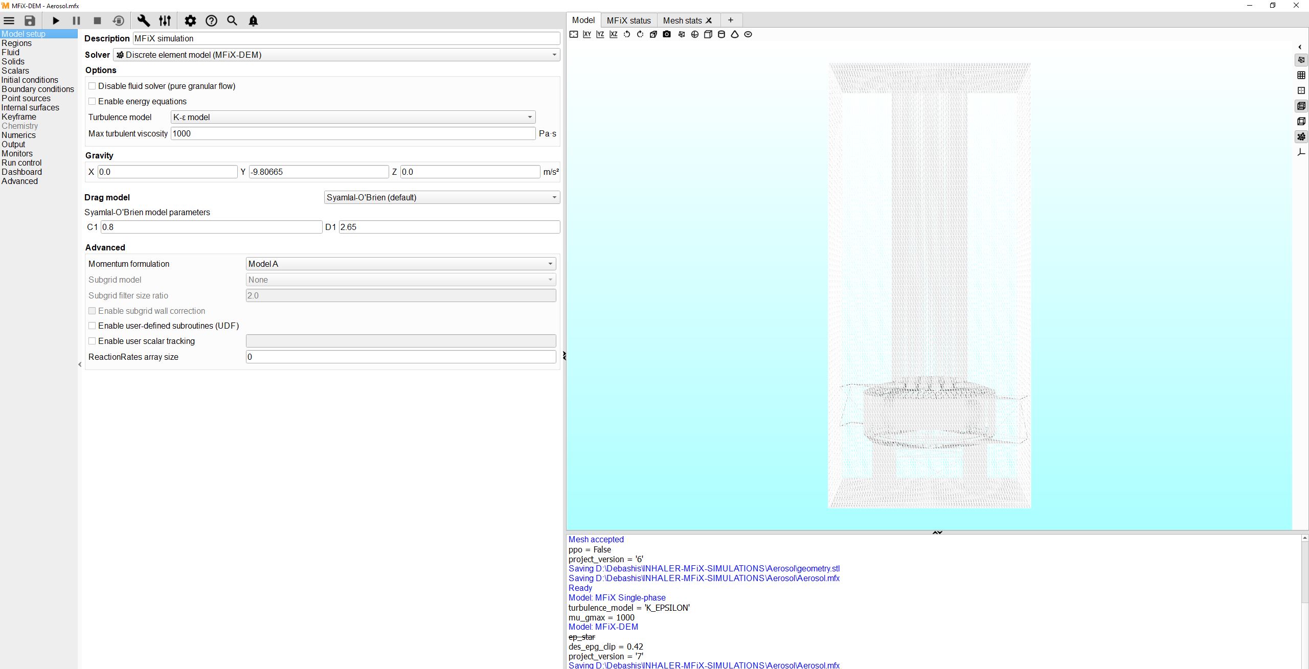

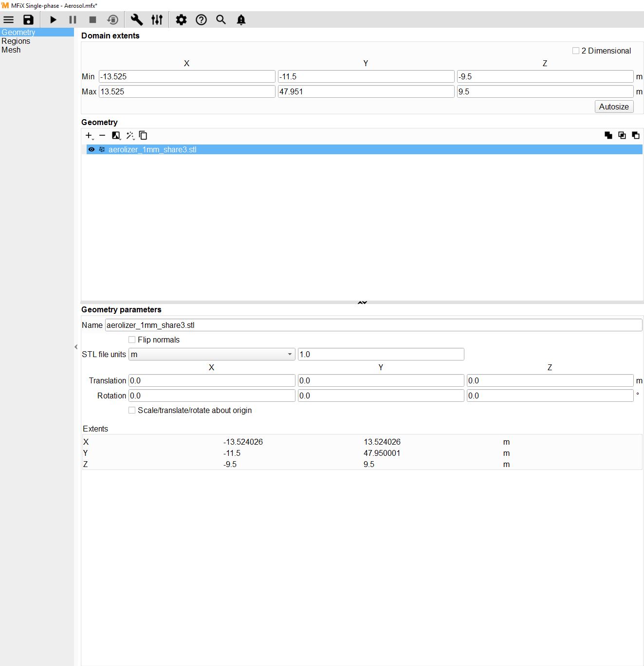

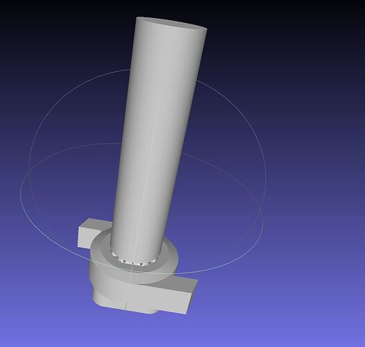

I am uploading some file including the .stl file.

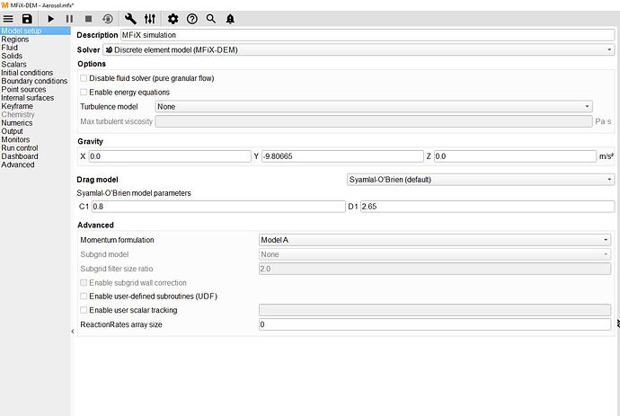

It will be a MFiX-DEM simulation with both flow and velocity.
Any suggestion on what tutorial I should follow will be helpful.
Thanks and Best Regards,
Sincerely,

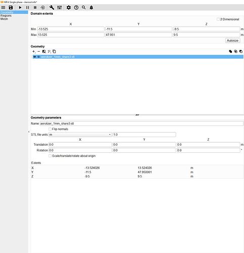

Aerolizer_1mm_share3.stl (1.4 MB)
Aerosol.mfx (4.6 KB)

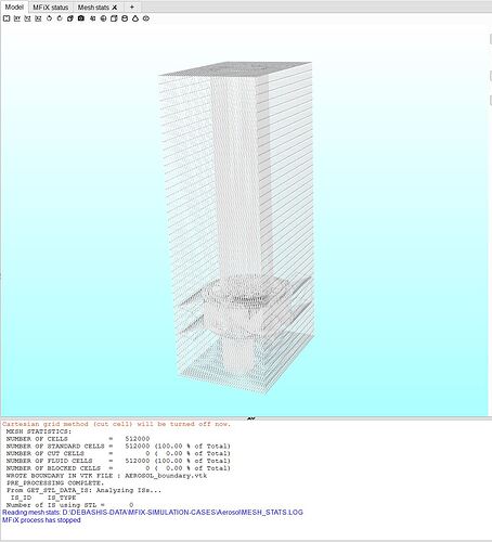

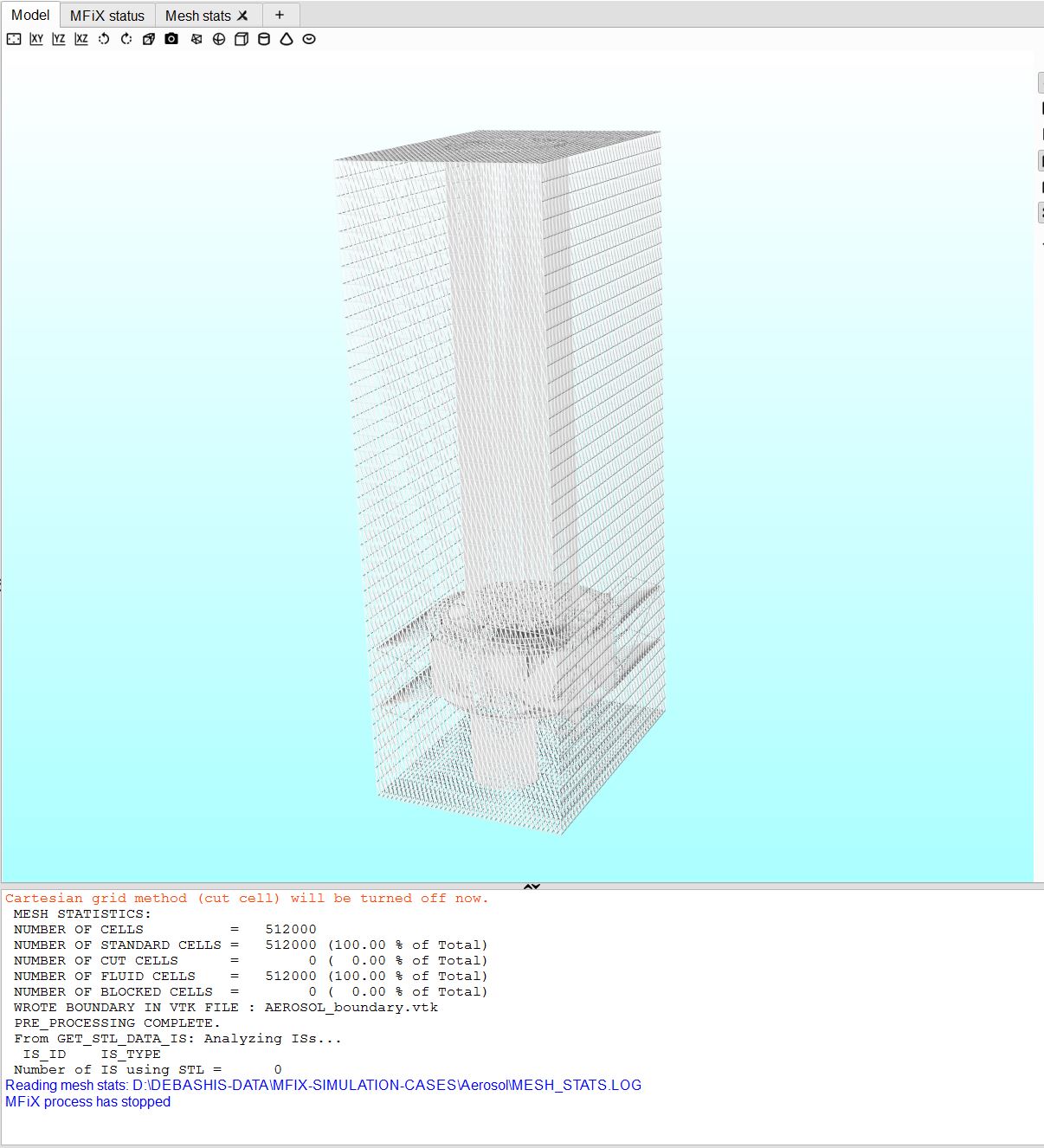

I am trying to set up the problem. Is there any information available on how to simulate the rotating motion ?
This geometry has two inlets and one outlet with particle injection region.
Any help on how to impart the rotation will be very helpful.

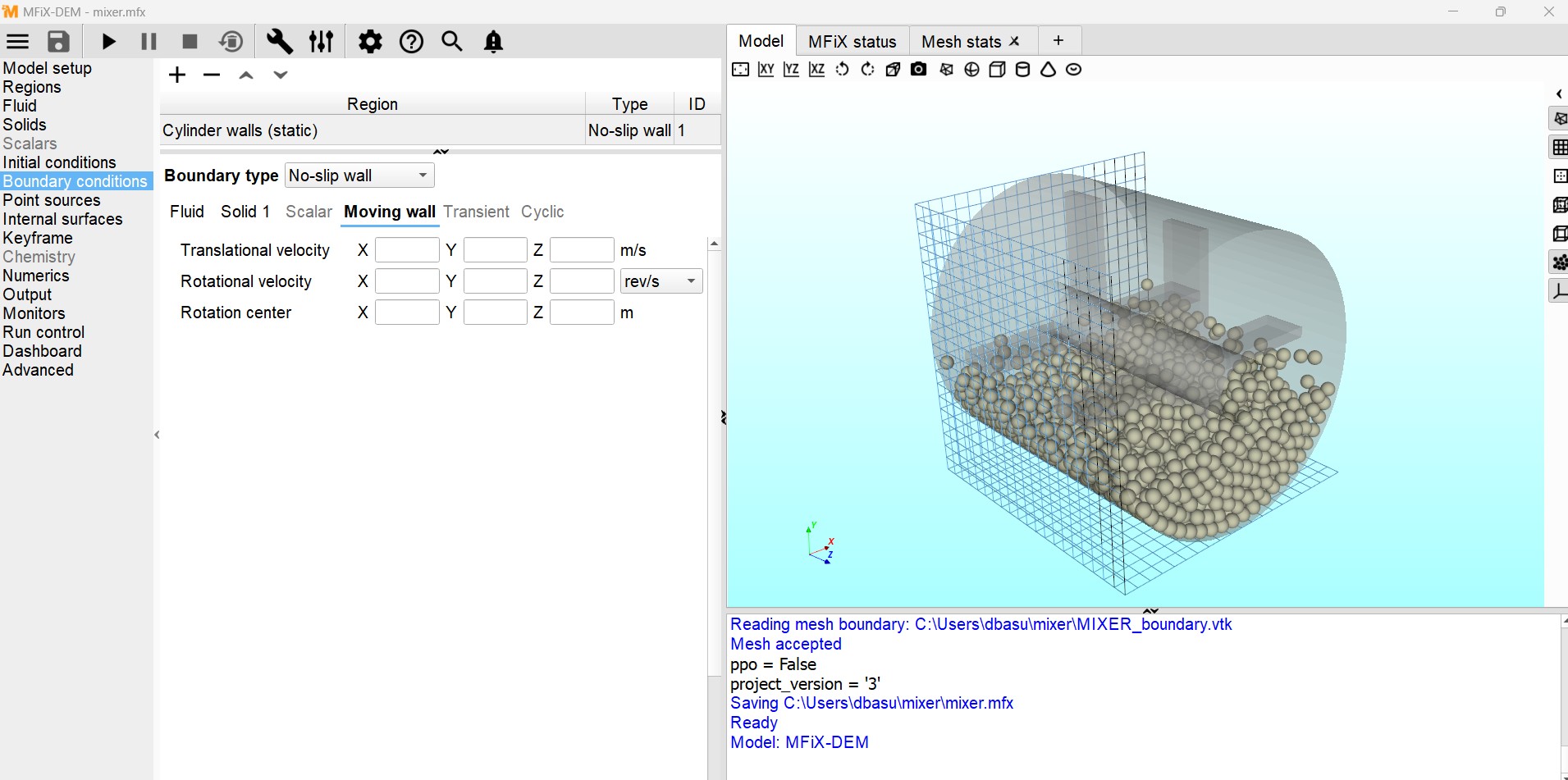

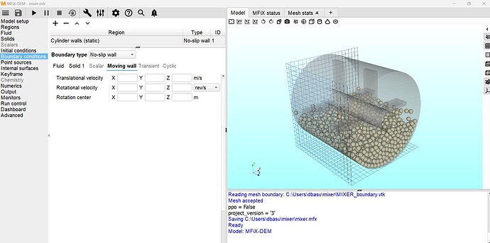

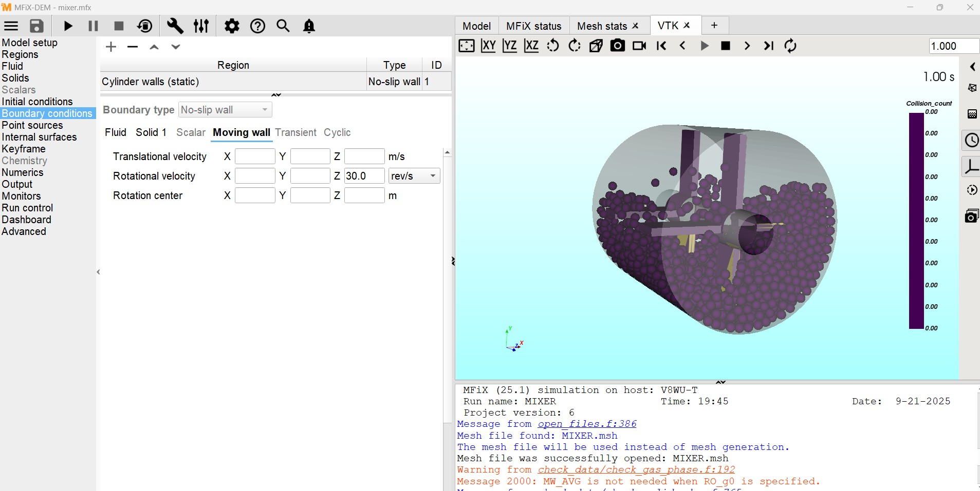

Please see the mixer tutorial which has rotating blades
mixer.mfx (10.7 KB)
Dr. Waldman,
Thank you.

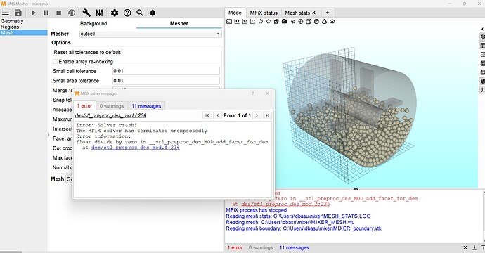

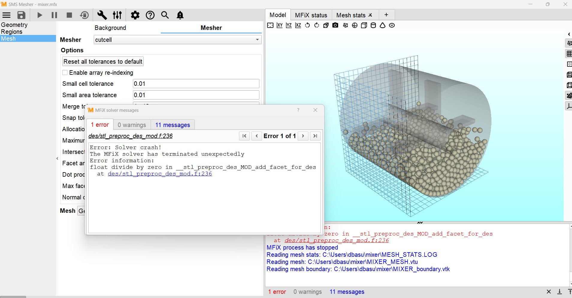

I started to go over the tutorial case on 3D Mixer. However, I got error message when I tried to generate mesh. I still ran it. Attached are some movie files. I am attached the .mfx file as well. In my case, however, the whole STL file (inhaler) is rotating. Do I need to change in usr1_des.f the direction of rotation etc. to start this ? Please suggest. Also, as I tried to change the particle diameter to 1 mm the particles seem to fly away.

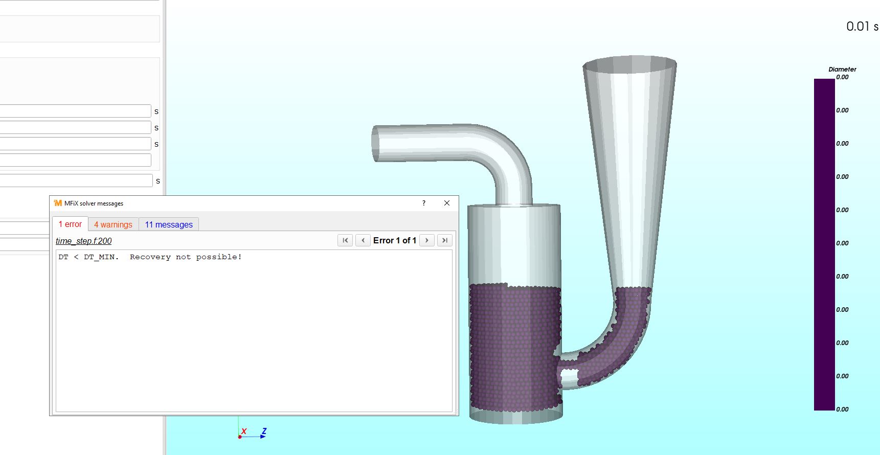

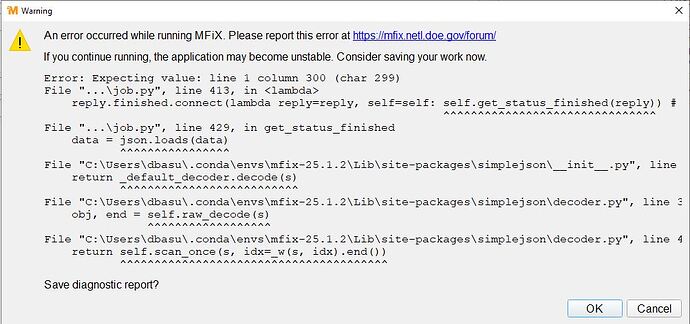

I am trying to run this tutorial case.
But getting error messages.
I am uploading all the files as well as the error messages.
Please let me know where I am making mistake in running this case.
Sincerely,

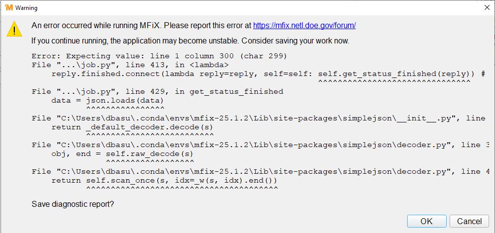

The second error (“Expecting value”) can be ignored, this unfortunately happens when the solver exits and the GUI is still trying to monitor job status. I believe it is fixed in more recent versions of MFIX.
The real problem is the divergence (DT < DT_MIN). Are you running the tutorial case unmodified, or did you make some changes to it?
I am running it unmodified.
I see you are running with 44 SMP threads:
 Number of SMP threads: 44
Do you see the same problem if you run in serial mode? Or a smaller number of SMP threads?
I will try that and let you know.
