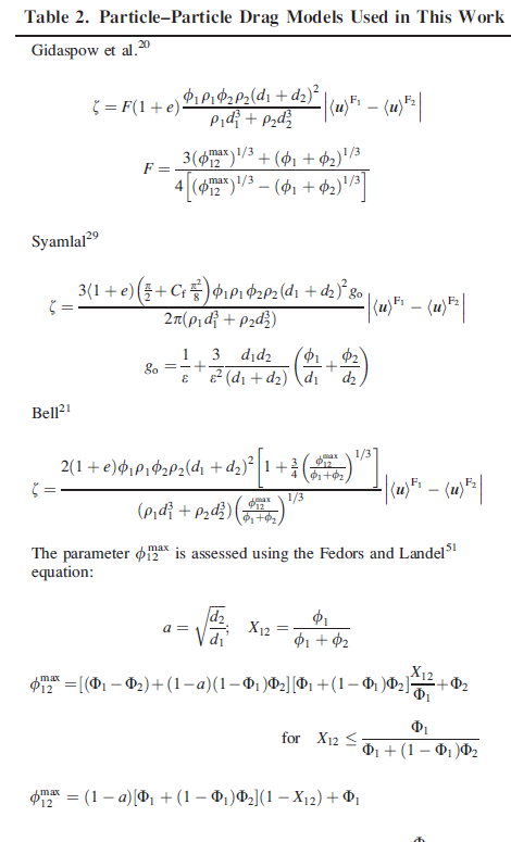

Thanks again for your help. I am still confused about the difference between the solid-solid drag and c_f here in MFIX. Are they actually two different models to show the interaction of two kinds of solid phases? Also, did you see any references that used c_f in segregation/mix study?
Read the theory document about the solid-solid drag model in mfix
mfix-19.3.0\mfix-19.3.0\doc\archive\theory
Also see the following reference on application of the solid drag in particle segregation study in fluidized bed:
Hydrodynamics of particle segregation in fluidized beds,International Journal of Multiphase Flow,2004,
Pages 419-428,
https://doi.org/10.1016/j.ijmultiphaseflow.2004.01.003.
Also see the comparison of different solid-solid drag models:
CFD modeling of binary‐fluidized suspensions and investigation of role of particle–particle drag on mixing and segregation,AIChE Journal 2007,1924-1940
https://aiche.onlinelibrary.wiley.com/doi/10.1002/aic.11227
