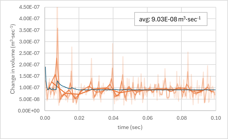

The figure below shows the change in solids volume with time. The lightest line is approximately the instantaneous change in solids volume (every five steps) and the darkest line uses a sampling interval 16 times longer showing that the inflow is approaching the targeted flow rate ~9.0e-8 m3/sec.
The fix was merged into develop today.
