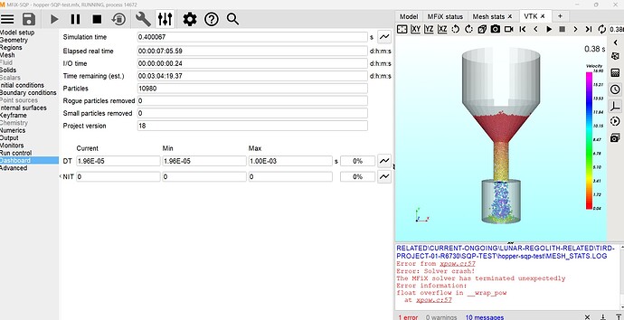

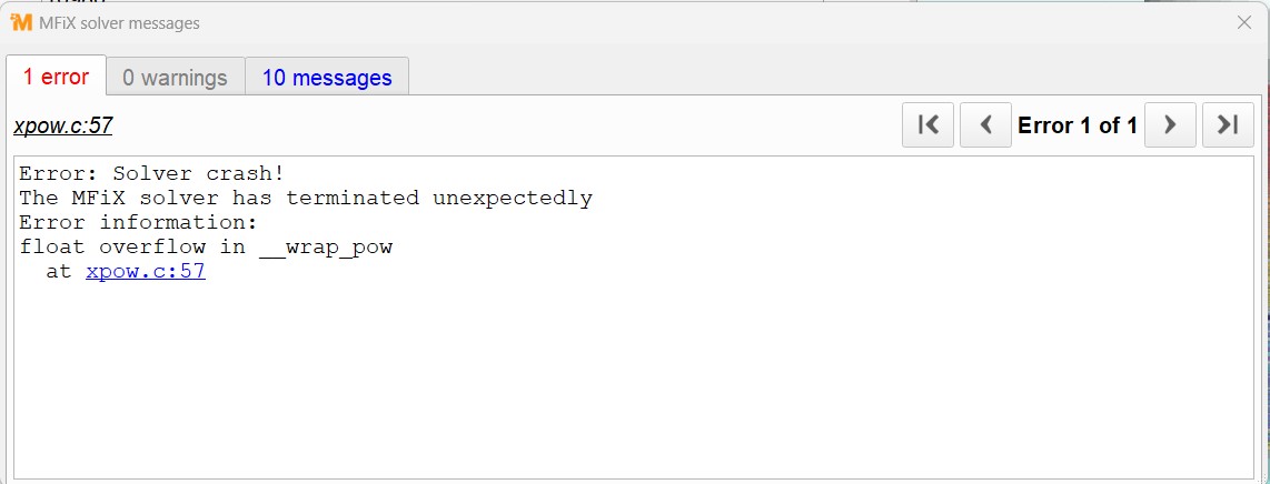

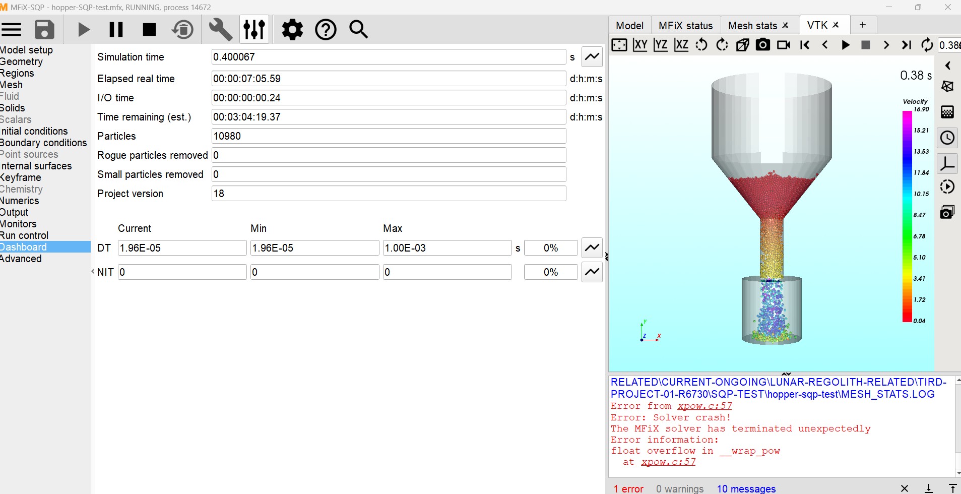

SQP case crashing unexpectedly
I am trying to run this simple case using SQP. It started running, the particles are moving and then suddenly it blows up. I am attaching the bug report file and also the movie file until the time it ran.
Kindly help me to understand what is the problem here and how to fix it. I will also need to simulate a case with 25% particles cube, 25% cylindrical, 25% elliptical and 25% spherical. Once I fix this problem, I will start that.

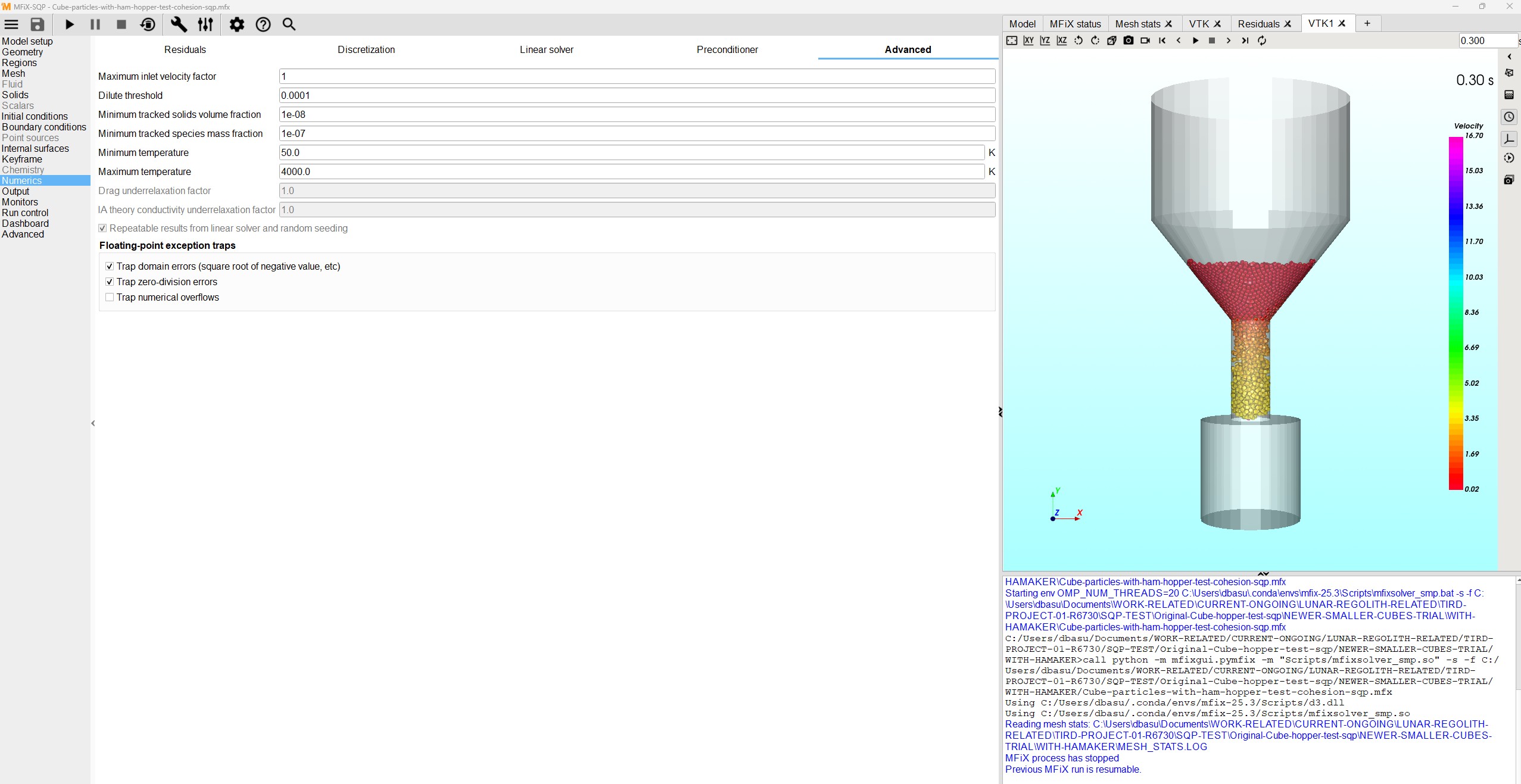

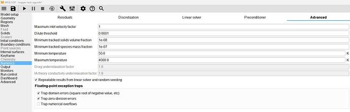

You could try disabling overflow checks.

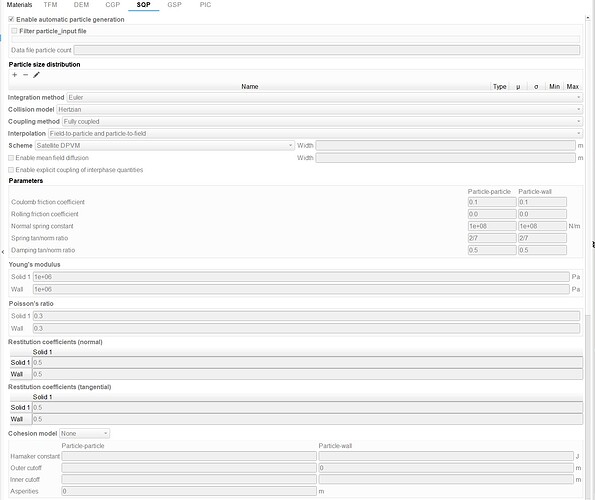

How to do that in the GUI set up ? Please let me know.

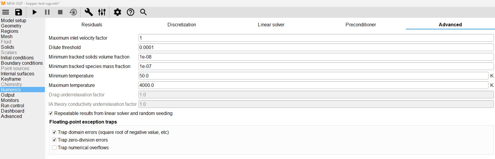

Is this the way to do this ? Kindly confirm.
Yes. Does that help?
hopper-test-sqp_2026-03-18T132518.577254.zip (48.1 MB)
Dr. Dietiker,
Happy to inform that everything worked. I am attaching the movie file for this. I will try the 0.01 m diameter now by varying the SQP parameters and let you know.

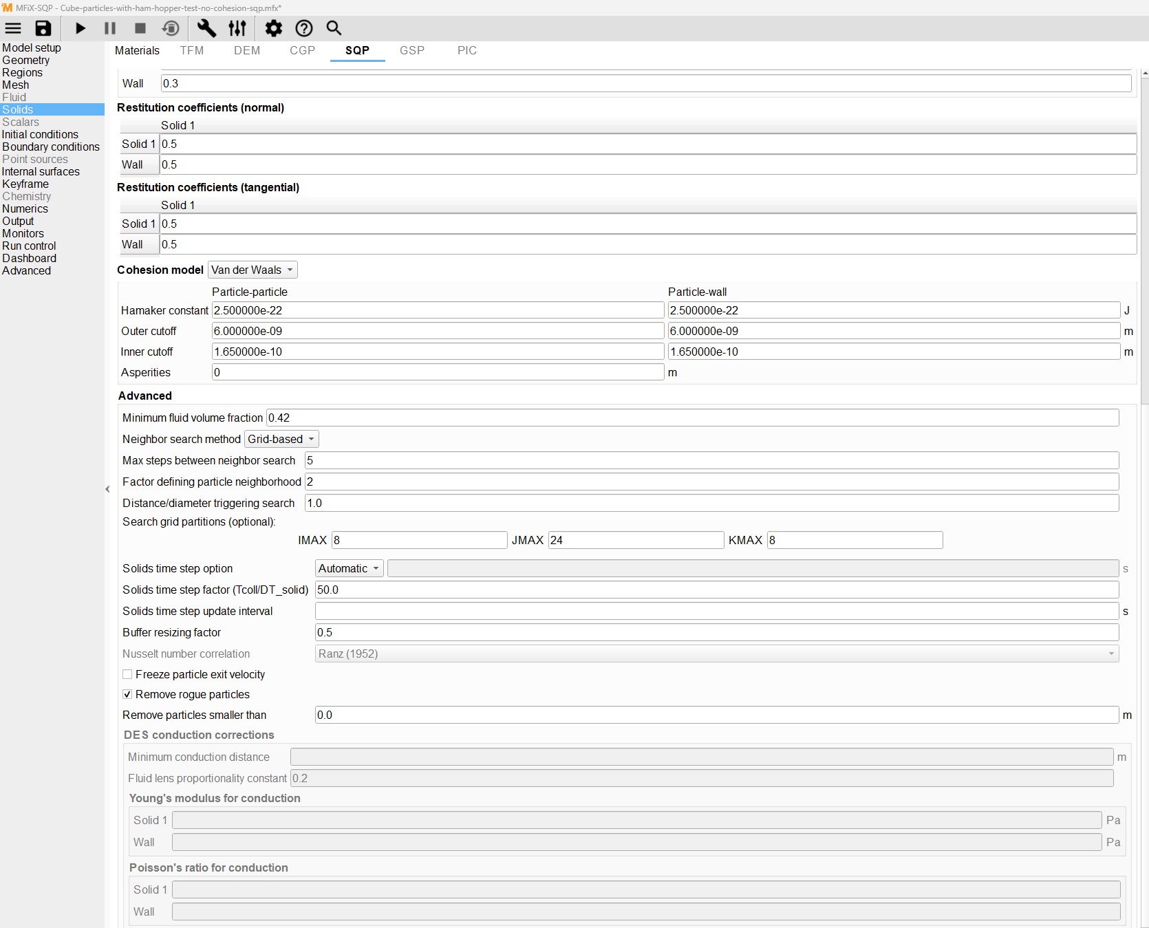

Dr. Dietiker,

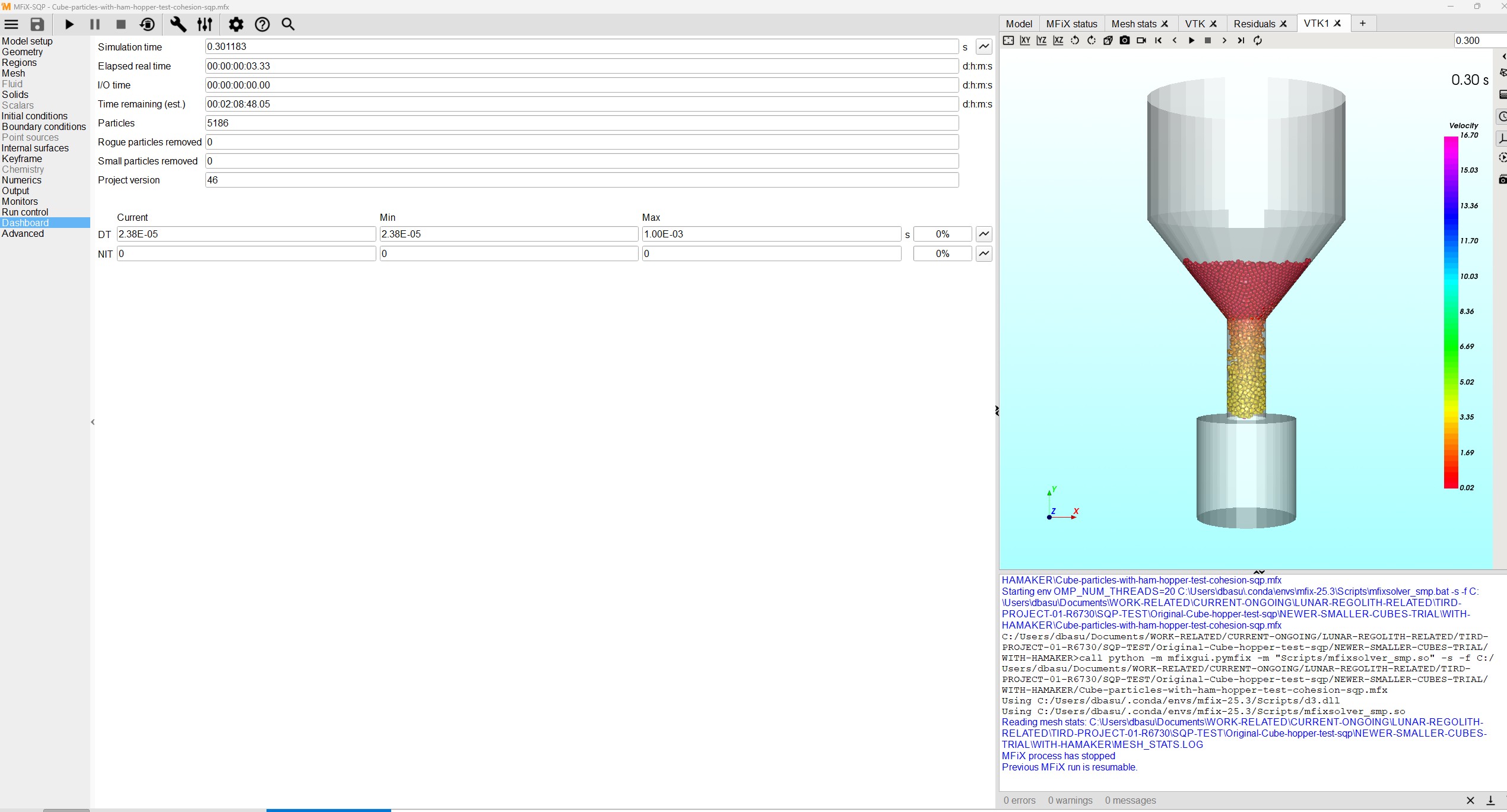

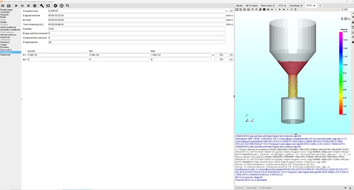

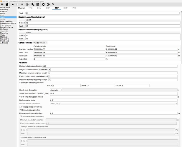

As I try to run the same case with Hamaker constant, it starts running but stops unexpectedly after 0.3 s without any error message. I am uploading the Zipped file, movie file etc. Kindly have a look and let me know what is the problem. How I can run this model.
Thanks and Best Regards,
