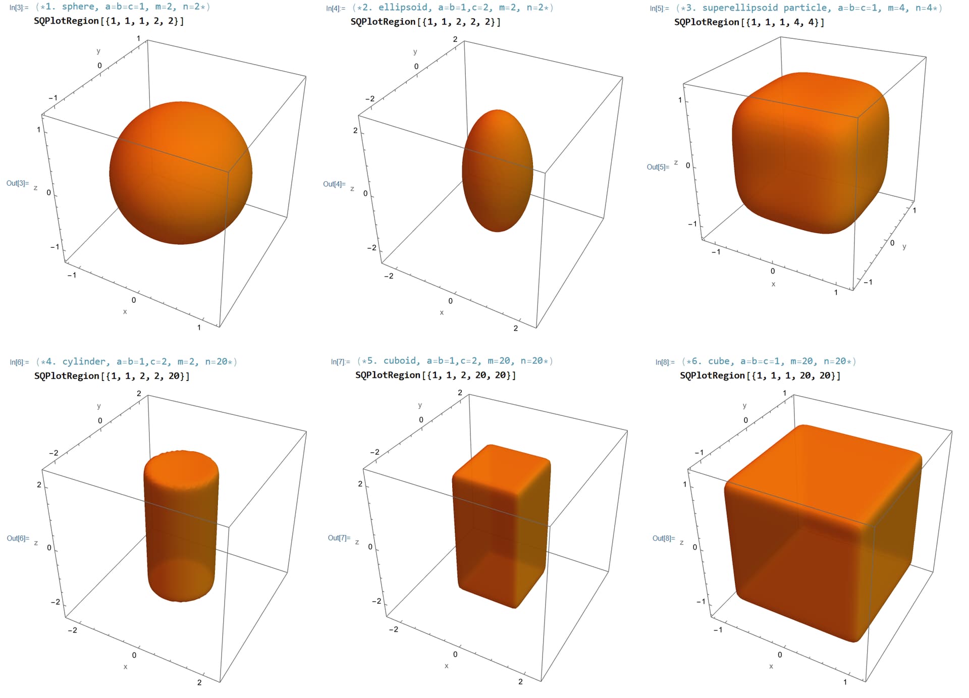

Hi, Debashis. I guess this question is common, especially when you use the superquadric equation for the first time. The easy way to understand this equation is to plot its 3d surface. There is a tool in MFiX’s GUI (graphical user interface) that shows the SQP’s shape. If you are familiar with some mathematical software, such as MATLAB and Mathematica, you can also plot directly.
Note, the relation of some commonly used variables of the superquadric equation: m=2/e2, n=2/e1.
Attached are two examples of 3D surfaces plotted in MATLAB and Mathematica.
The Matlab script is modified from this reference:
https://www.mathworks.com/matlabcentral/fileexchange/40673-minimum-distance-between-two-superellipsoids
Plot by Matlab:
Plot by Mathematica:
