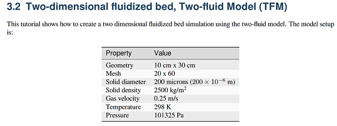

官方的tfm案例为什么算出来有错误
当我跟着官网的TFM案例一步步过来的时候,到最后计算的时候会报错。我试着重新去操作了一边,依旧会报错。

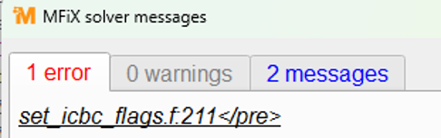

Hi. Sorry, I can’t read Chinese. If you want help from the development team, please attach your input files, as well as all log files.
The code at set_icbc_flags.f:211 looks like this:
! If an error is detected, have each rank open a log file and write
! it's own message. Otherwise, we need to send all the data back to
! PE_IO and that's too much work!
      IF(ERROR) THEN
         CALL OPEN_PE_LOG(IER)
         WRITE(ERR_MSG, 1100) trim(iVal(myPE))
         CALL LOG_MESSAGE(__FILE__, __LINE__, LOGLEVEL_INFO, FOOTER=.FALSE.)
         DO K = kStart2, kEnd2
         DO J = jStart2, jEnd2
         DO I = iStart2, iEnd2
            IF(ICBC_FLAG(FUNIJK(I,J,K)) == '   ') THEN
               WRITE(ERR_MSG,1101) I, J, K
               CALL LOG_MESSAGE(__FILE__, __LINE__, LOGLEVEL_INFO, HEADER=.FALSE., FOOTER=.FALSE.)
            ENDIF
         ENDDO
         ENDDO
         ENDDO
         CALL LOG_ERROR()
which shows that the actual error message is in a different file OPEN_PE_LOG(IER)
