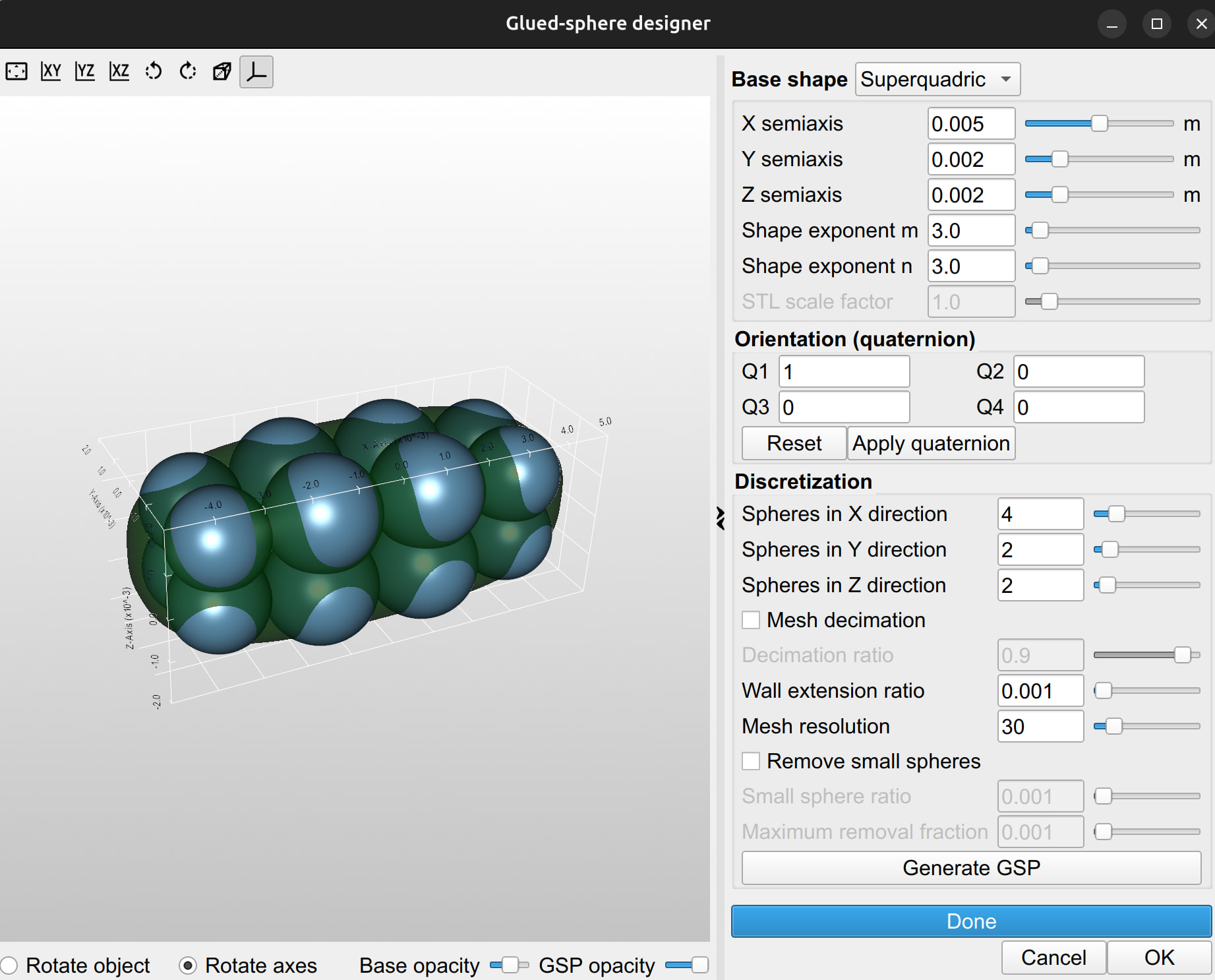

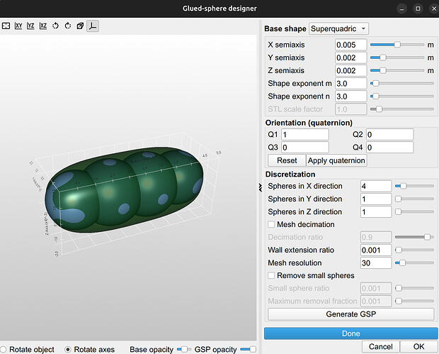

For the next person coming across this problem, I created a minimal example where I spawn GSP particles based on a simple superquadratic with 4x1x1, 4x2x2, 4x3x3 spheres. This is a simple way to change component sphere sizes without getting any really small spheres. See images below:
I then spawn the particles from the top falling down in a simple square domain.
I wrote down the DEM time-step for each simulation and it yielded
GSP 4x1x1 - dt_solid=0.414423E-04 s
GSP 4x2x2 - dt_solid=0.366915E-04 s
GSP 4x3x3 - dt_solid=0.366915E-04 s
So the time-step is basicly unchanged despite the component spheres becoming much smaller.
Below is the videos of each of the three cases where its clear that only the 4x1x1 case has a sufficiently small time-step.
If I take the case with 4x2x2 and set dtsolid_factor=100 (2x the default 50) we get a working simulation.
