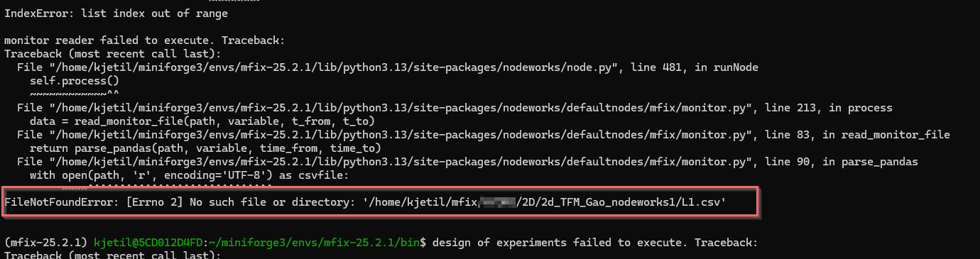

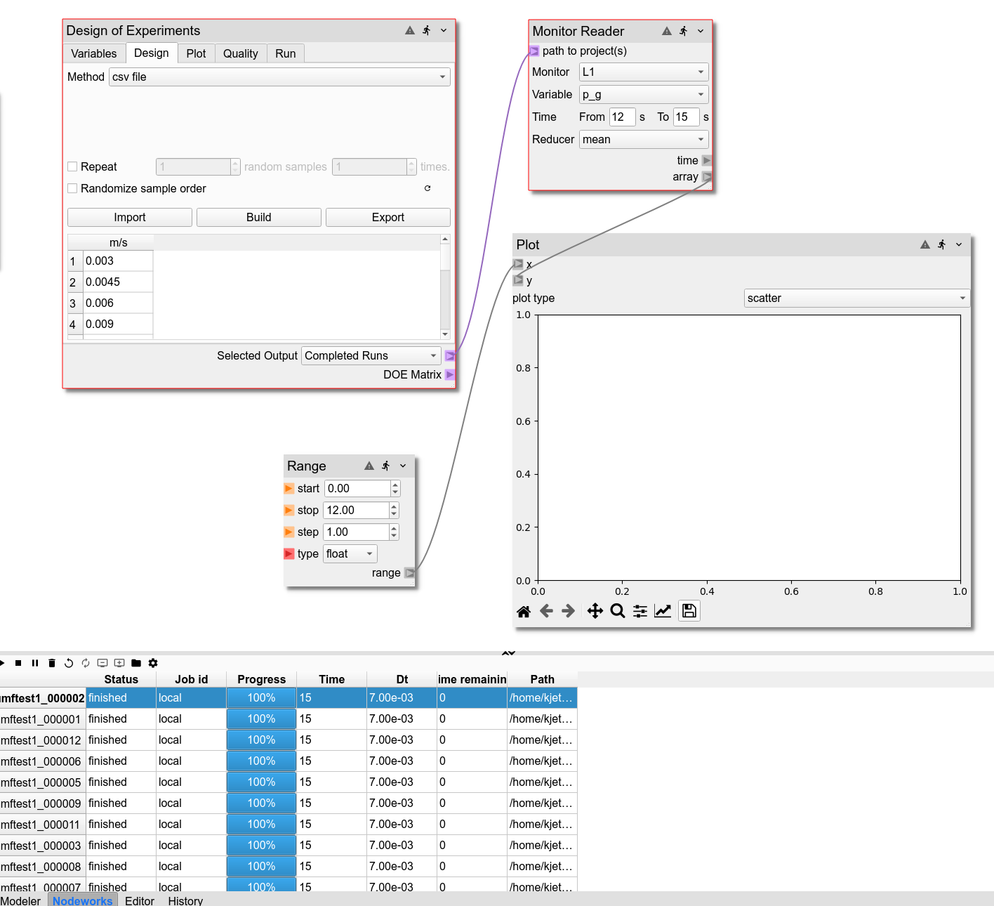

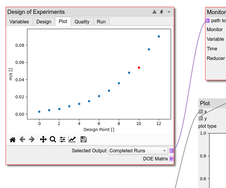

I’m doing a slightly modified Umf example, reading the variable levels from a .csv file. The import went just fine, I deselected one point when looking at the plot prior to running, and all simulations ran without any problems. It is only afterwards that the plotting does not quite work. And when looking at the output in terminal, the DOE node tries to open monitor files outside the prefixed run directories. That is a bit surprising, and happens both when using “All runs” and “Completed runs”. Shouldn’t it walk through the different run directories?
Also, there was something a little strange when I tried to setup everything in the beginning, and writing the .mfx files; when launching the run, it could not find the .mfx files anymore. Or more specifically it wrote file names using the MFIX case run name, while it later (when launching the run) was looking for these run files using a different file name, which seemed to be the original (parent) filename where this nodeworks case was setup. Can these two things be related somehow? I overcame this first hurdle by changing the case name to the file name.
Nodeworks setup:
The leves given by .csv:
