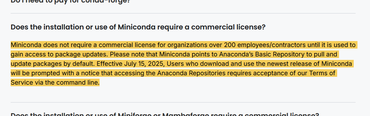

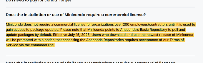

Apparently also Miniconda follows the Anaconda license structure. I have the same issue on my workplace. Miniconda will use the same repos/servers as Anaconda, which is why it is still blocked for @oyedejifemi.
From https://www.anaconda.com/legal:
This is confusing, but Miniconda is not the same thing as Miniforge
Miniconda is produced by Anaconda Inc while Miniforge is a community-driven effort which is not subject to Anaconda’s license terms.
Wow, sorry for adding to the confusion! I must say I have actually used the Miniforge install myself. But I have also experienced connection problems when installing MFiX at work, where I believe Anaconda servers specifically have been blocked.
In my opinion, the blanket ban on the Anaconda servers is misguided and counterproductive. But there’s really nothing I can do about it except to urge you to complain to the folks who are implementing it. Miniforge is hosted on resources donated by Ananconda Inc so there’s no way to untangle the two based on IP address :frowning:
