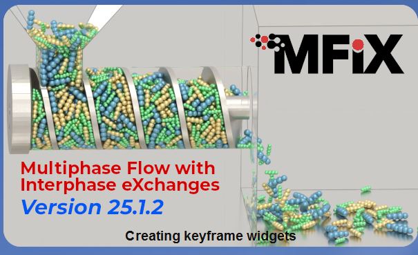

I am currently using MFiX 25.1.2 (screenshot attached) and it is working fine.

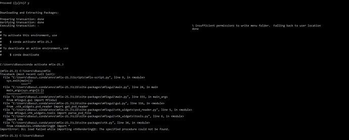

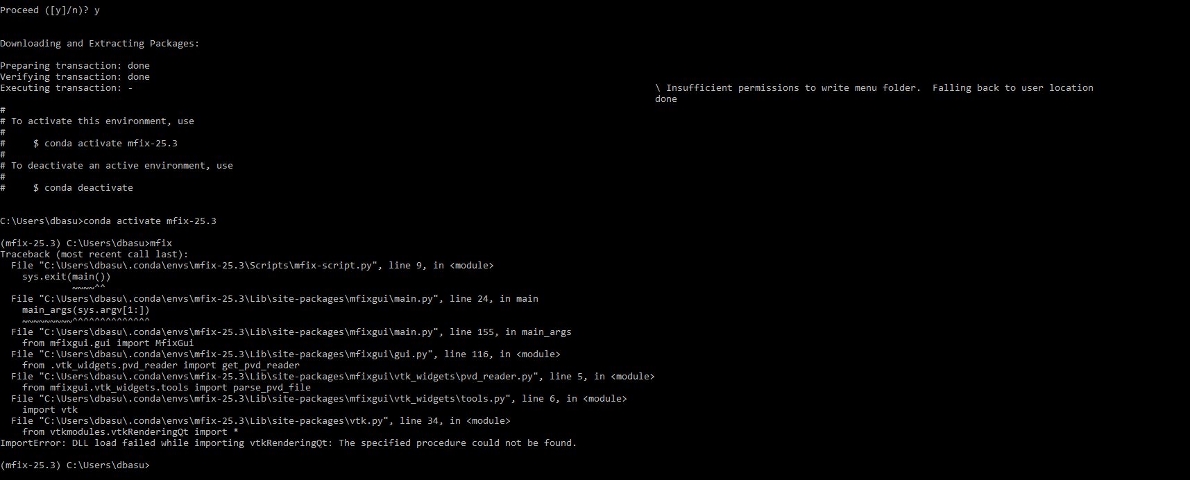

It seems to be getting installed but when I am trying to open it is giving the error message a shown in the first screenshot. Seems like something related to Python.

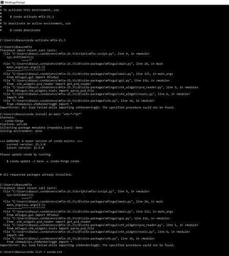

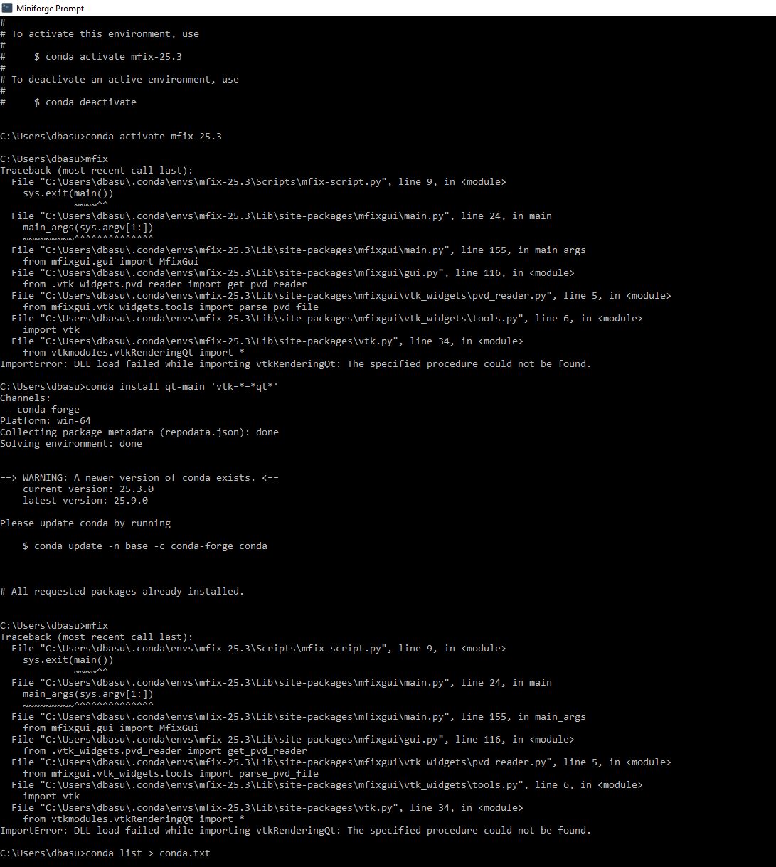

I tried the commands you suggested. But still getting the error message.
I have attached the screenshot as well as the conda.txt file for your kind review.

I’m looking for a solution. Since MFiX 25.3 works on my test Windows system, it’s a little hard to see what’s going wrong on yours. The conda.txt file you attached looks fine - I have the same versions of all packages and I’m not seeing any errors. It would be helpful to know exactly what DLL it’s complaing about. I’m not quite sure how to do that. I’ll try to find more information on debugging this and get back to you when I have a clearer idea of how to proceed.
