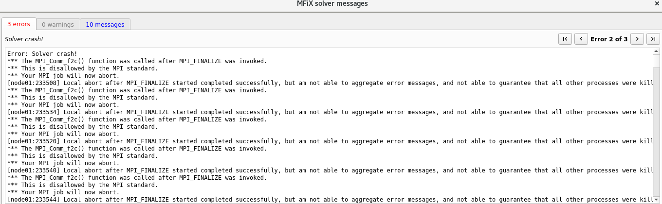

In addition, I encountered a new problem during the simulation. In the middle of the simulation, there is a sudden “solver crash” error, as the picture shows, what is the reason? The required mfix file has been uploaded.Thanks!
1cm-3cm-15cm-0.85mm-303.15K-water0.15-20s+10s-second.mfx (12.0 KB)
