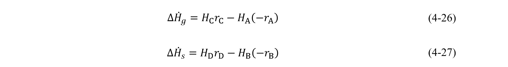

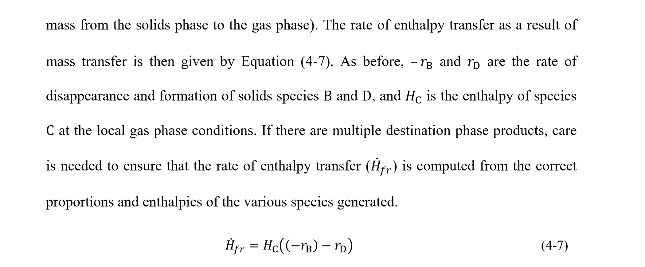

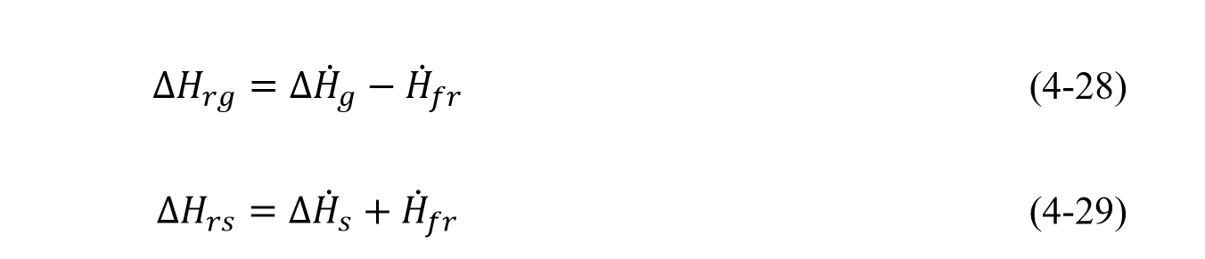

Thank you! There is also a question I would like to ask you, why is the source term of a chemical reaction opposite to the heat of reaction in mfix?
I’m not sure I understand the question. Are you perhaps confusing heat of reaction with heat of formation?
