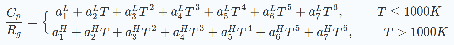

I don’t know which equation it uses, but because there are 7 coefficients, I guess it uses eq. (7)
If so, there is a obvious contradiction between
(let us call this equation aaa)
and
![图片](http://discourse-attachments.s3.dualstack.us-west-2.amazonaws.com/original/2X/3/376284f1b985489c5c5d1e6132b9b7ef10a3393f.png)
Finally, let me conclude my question:
Which equation is true for MFiX when calculating Cp? eq (aaa) or eq (7)?
