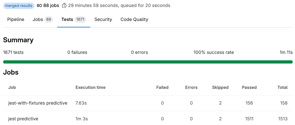

View Unit test reports on GitLab
If JUnit report format XML files are generated and uploaded as part of a pipeline, these reports can be viewed inside the pipelines details page. The Tests tab on this page displays a list of test suites and cases reported from the XML file.
Test Reports Widget
You can view all the known test suites and select each of these to see further details, including the cases that make up the suite.

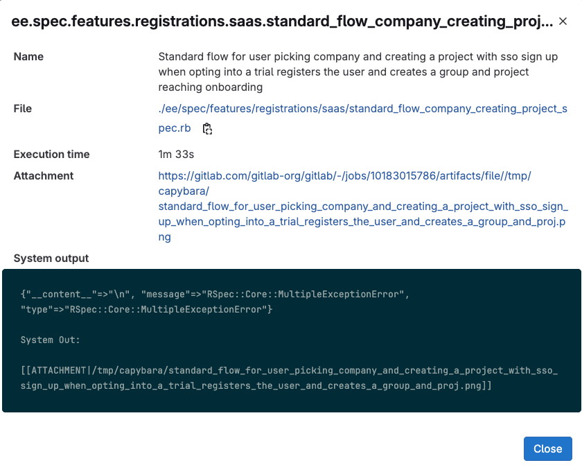

View JUnit screenshots on GitLab
You can upload your screenshots as artifacts to GitLab. If JUnit report format XML files contain an attachment tag, GitLab parses the attachment. When uploading screenshot artifacts:
  • The attachment tag must contain the relative path to $CI_PROJECT_DIR of the screenshots you uploaded. For example:
    <testcase time="1.00" name="Test">
      <system-out>[[ATTACHMENT|/path/to/some/file]]</system-out>
    </testcase>
  • You should set the job that uploads the screenshot to artifacts:when: always so that it still uploads a screenshot when a test fails.
After the attachment is uploaded, the pipeline test report contains a link to the screenshot, for example:
Unit test report screenshot example
