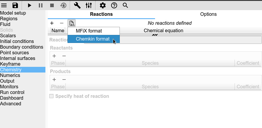

On the Chemistry pane, Reactions sub-pane:
Click
Load reaction definitions from text fileand selectChemkin formatSelect the mechanism file “chemkin_mechanism.CKI” in the popup window. Click
Open.
Then all the reactions with all the information will be imported

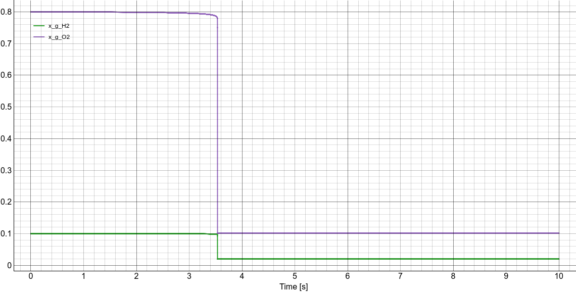

3.11.8. View results¶
This tutorial simulates the oxidation of H2 in a batch reactor. Users should expect to see consumption of H2 and O2 and a temperature increase from the exothermic reaction.
next to the Model tab
Select
Monitorsto view the results.On the
Monitorsresults tab, the visibility of the variables can be controlled with the menu under the plot.
Hide the gas temperature by unclick the
for variable t_g. The following plot with the transient changes of the mass fraction of H2 and O2 will be shown.
Hide the gas species by unclick the
for variables x_g_H2 and x_g_O2. The following plot with the transient change of the gas temperature will be shown.
