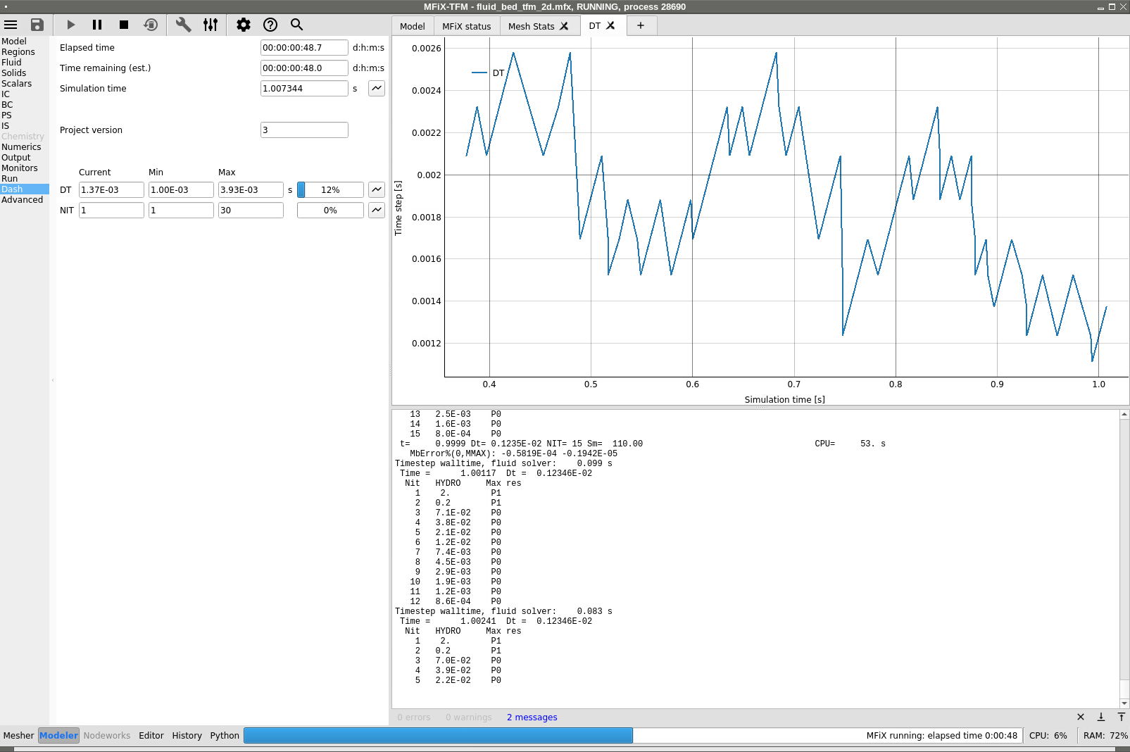

The MFiX Interactive Solver can interact with the GUI through http communication while the solver is running. Information about the flow solution can be passed directly from the solver to the GUI. For example, the simulation status, current simulation time, time step and residual information is communicated directly to the GUI, which can display or plot this information. The Dashboard view summarizes the progress of the simulation.

The GUI can also control the status of the simulation. A simulation can be paused, resumed and stopped. Pausing/resuming a simulation is useful when some settings need to be adjusted without terminating the simulation. This feature is particularly useful when the solver runs in a queue system. Here some parameters can be changed and take effect upon resuming the simulation without exiting the queue.
It should be noted that only a few settings can be adjusted with the pause/resume feature. Typical settings that can be changed include the final time, inlet boundary condition velocity/flow rate and numerics parameters. Settings that cannot be changed (say the mesh resolution of fluid/solids material properties) are greyed out while the simulation is paused.
The run status is controlled by the play, pause, and stop icons ( Start Pause Stop ) located along the top bar. A simulation is started by pressing Start. At any time during a simulation, it can be paused by pressing Pause. If the simulations was launched through a queue system, it will stay in the queue while paused (the elapsed time is still continuing). Editable settings will unlock while non-editable settings will stay greyed out. Once a setting has been modified, the project needs to be saved and the simulation can resume by pressing Start again (if the project was not saved, the user will be prompted to save it).
A simulation can be stopped by pressing the Stop. This will write a restart file corresponding to a snapshot of the simulation at the time the simulation was stopped and terminate the run. If the simulations was launched through a queue system, it will exit the queue.
