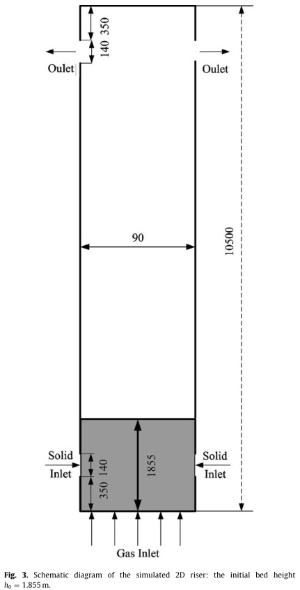

Hello everyone, I want to simulate riser by TFM, but the operation is always divergent.The case is set according to literature parameters. Could you please help me with this problem. My example is set on mfix-21.1.4. The example file is as follows: Thanks!!!
riser_li.mfx (21.3 KB)
