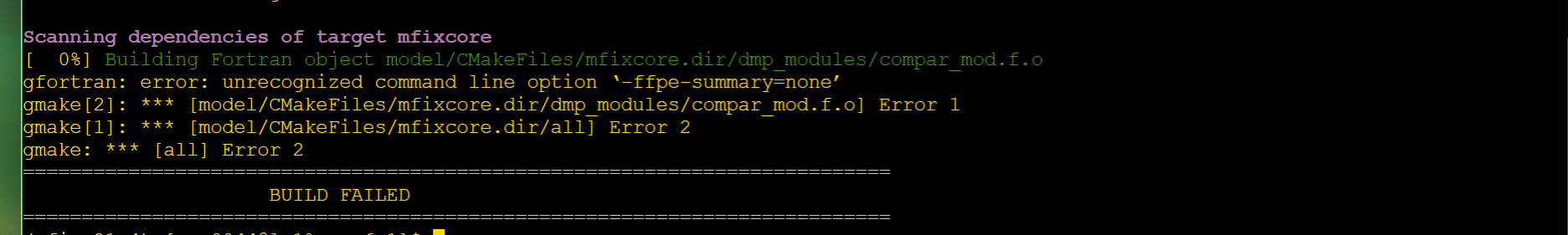

Hi, Charles
There are two version of MFIX installed on commercial HPC. Using the same mfix source files, solver can be successfully built with the version 20.2.1, but failed with the lasted version 21.4. Can you please tell me how to solve this problem? Thank you.
Please see Compilation failure in serial/smp/dmp with MFIX-21.3
