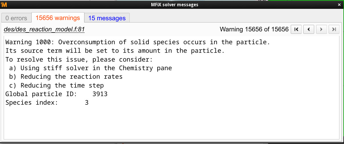

When I tried to run this I got over 15,000 errors. Most of them are the same message, getting printed for each particle:

You should see the output gets flooded with this kind of message:
Warning 1000: Overconsumption of solid species occurs in the particle.
Its source term will be set to its amount in the particle.
To resolve this issue, please consider:
 a) Using stiff solver in the Chemistry pane
 b) Reducing the reaction rates
 c) Reducing the time step
Global particle ID:    2185
Species index:       3
This indicates the reaction rates are very large. Please switch to the stiff solver and verify your reaction rates are correctly implemented.
