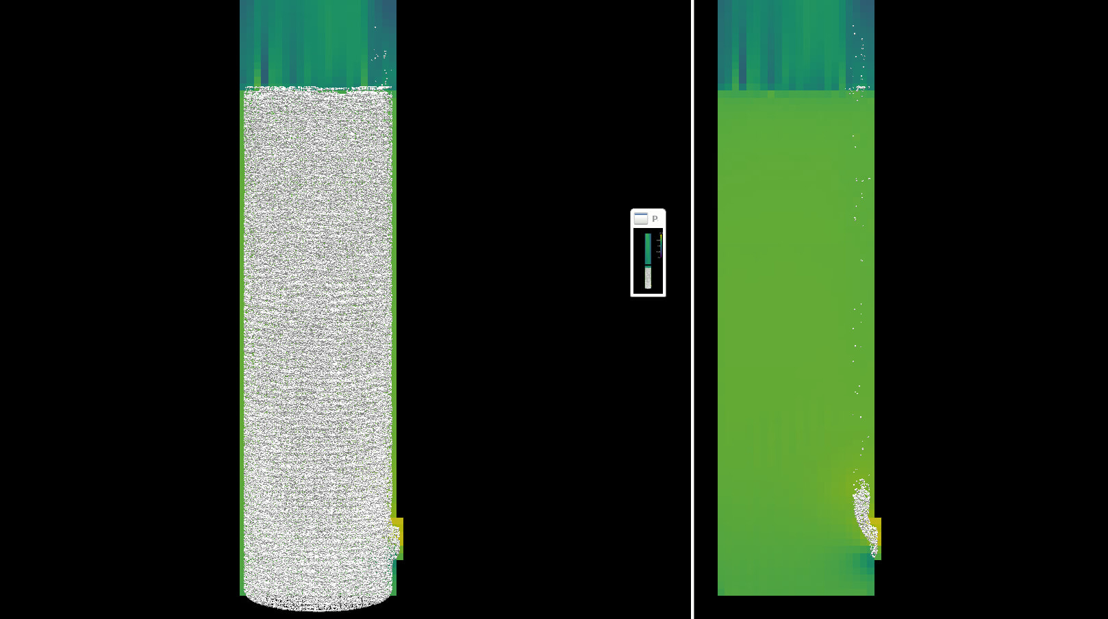

There’s also something very odd about the png files Ascent is creating:
I’m seeing this message in the output log:
s2/p2 pseudocolor plot yielded no data, i.e., no cells remain
which is the same message Yupeng reported in a different case.
It seems to be an issue with the slice filter. With 24 cells in y and max_grid_size = 6, you get 4 box divisions in y. The domain is y = -0.05 to 0.05, so the box boundaries in y fall at -0.05, -0.025, 0.0, 0.025, 0.05. The slice at y=0 sits exactly on a box boundary — so some boxes include it, some don’t, and you get that patchy checkerboard.
This is an Ascent/Viskores issue with how the slice filter handles the AMReX box decomposition. A few things that could help:
  • Larger max_grid_size so fewer, bigger boxes means fewer misses
  • Making sure the slice position is centered on the domain rather than near a box boundary
  • Using a volume render or a different filter instead of a planar slice
I’m not yet sure whether this is the cause of the crash, or a separate issue.
That’s not what my images look like (see above). There’s nothing inherently wrong with that error message, that just means there’s nothing to display for some plot, e.g., you’re visualizing particles but you start w/ no particles and they all flow in (as one current post on here), or you’re doing contours of some turbulent iso-surface and you have to wait for it to develop, e.g., jordan/jeff’s amr post. I will say though that they all come out at the end though (at least for a release build), so if you’re looking to catch that warning on the first print, no dice.
