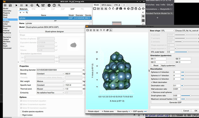

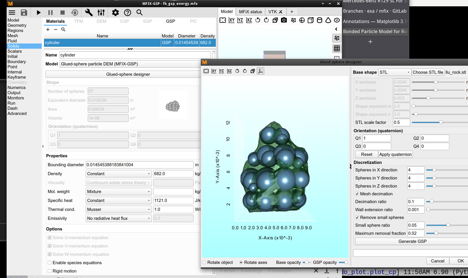

There is a Glued-Sphere particle model in MFiX, is that what you are looking for? Check out the GSP tutorials like “fb_gsp_energy” (Fluidized bed with energy equation - Glued-sphere) which is modeled on a rock

Open the GUI, select “New Project” and you will see all the available tutorials. You can filter by model type. There are examples for all available models. These are not all step-by-step tutorials, but they are examples for you to study.
