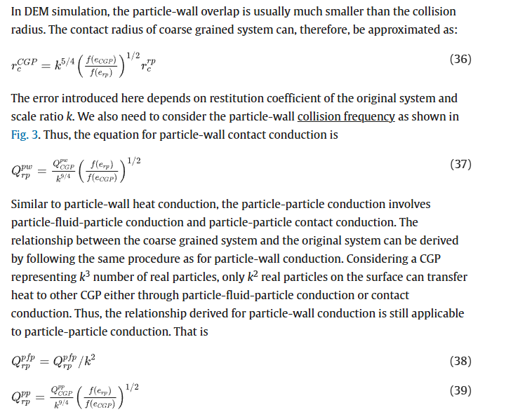

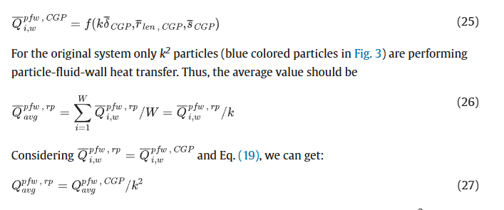

Thank you very much for your reply, Eduardo. I believe what you’ve stated aligns with the answers I’ve obtained. I’m not sure if I’ve misunderstood you. Are you saying that MFIX handles CGP by modifying particle property parameters to achieve force scaling? Whereas some papers calculate the actual particle force first, then multiply it by a scaling factor to obtain the parcel force, which is then substituted into the motion equation? Based on my reasoning, when I apply Hertz’s collision law, if particle properties remain unchanged, it should precisely align with the relative overlap law (I’m not certain if this is correct; please correct me if I’m wrong). After understanding how MFIX handles CGP, I encountered some questions while reviewing the heat transfer model. I don’t understand the derivation process for Qpfw and Qpw in the paper. I’m unsure if you’ve read Lu’s paper on the CGP heat transfer model, which is the CGP model used in MFIX. If you have read it, I have the following questions:
(1) Why use dimensionless quantities when deriving Qpfw? Additionally, I find some confusion in the derivation of equations 25-27.
(2) When deriving Qpw, the term k^5/4 in equation 36 suddenly changes to k^9/4 in equation 37, which seems highly unusual. The original text states, “We also need to consider the particle-wall collision frequency as shown in Fig. 3.” But why is k scaled by a factor of 9?

That is to say, the equation Qcgp = WQreal always holds true. Does the equation for Qreal derived in the paper represent the average value of all real particles within the inclusion?
(4) I also found that the code for Qpw in MFIX differs from that in Lu’s paper. Lu’s correction factor is k^(9/4), whereas MFIX uses W^(5/12) = k^(4/5). Furthermore, the paper states that Q_pp(real_particle) = Q_pp(Parcel_size_based_calculation)/W^(3/4), not the multiplicative relationship “Q_pp(real_particle) = Q_pp(Parcel_size_based_calculation)*W^(5/12).”
I’m truly sorry for the length of my message. Thank you so much for your patience in reading it. I look forward to continuing our conversation.

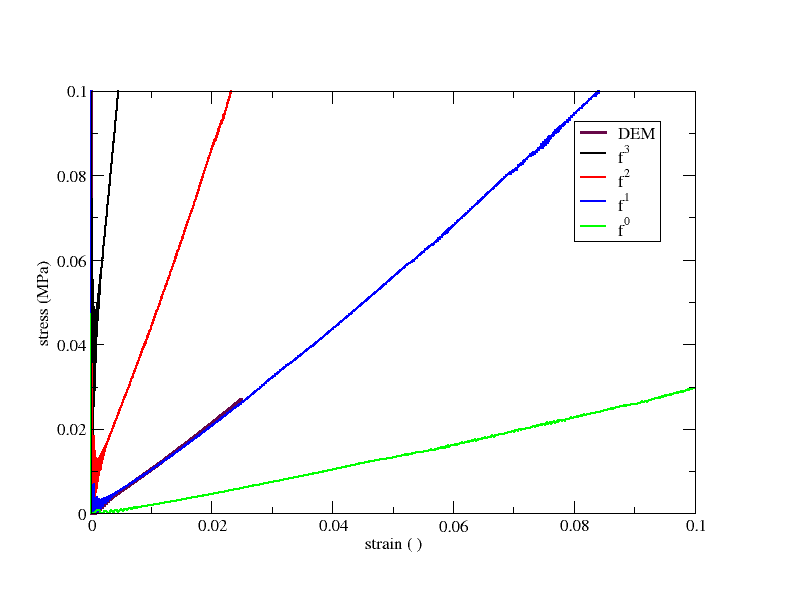

@edcanop I was curious about the uniaxial compression test you mentioned. Sorry to cross pollinate, but I am using MFIX-Exa. I ran a uniaxial compression test just as in the paper. The results are slightly different, likely due to Hertz vs LSD. (This is still running so it’s only a partial curve, but still enough to show my confusion.) Then, I coarse grain the particles by a factor of f = d_g / d_p = 4, i.e., f^3 = 64 “particles per grain.” I am scaling the spring constant by factors of f^0 = 1, f^1 = 4, f^2 = 16 and f^3. I expected to see either f^2 give the correct match in this test based on Eq. (28) or f^3 based on Eq. (28) combined with Eq. (35) in your referenced paper. Although, to be honest, I am really not sure how one is supposed to interpret Eq. (35) other than introducing a new factor in front of either the spring constant or, conversely, in front of dashpot coefficient, as in this paper. Anyway… have you done similar uniaxial tests w/ CG LSD DEM? Any insights into why f^1 scaling of k_n seems to be the right fudge factor for this test?

Fast answer would be that I did not test LSD DEM for the uniaxial compression test. However, I managed to make it work (i.e., obtained overlapping curves for the same f) modifying the underlying calculation of forces in the Hertzian contact model. My strategy was the following:
  • Unscale overlap by a factor of f.
  • Calculate all forces and torques based on downscaled (original) particle size.
  • Scale up the force by a factor f^2.
Anyhow, if I am not wrong, combining Eq. (28) with Eq. (35) of the paper actually indicates a factor f is the way. That is, if s is the scaled up particle and o is the original and only looking at a normal component:
Fs = Fo · f^2
deltas = deltao · f
Fs = kns · deltas = kns · deltao · f = f^2 · Fo = f^2 · kno · deltao
This yields that kns = f · kno, which I believe is why you are getting coherent results.

@edcanop your response finally helped me understand what the authors were trying to express in Eq. (35). thank you.
