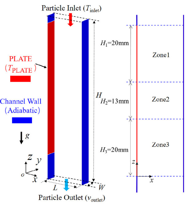

The velocity of particles is controlled at the outlet to ensure particles fill the whole volume of the heat exchanger. Therefore, additional forces are applied to the particles at the channel outlet to control the velocity of particles, as shown in Eq. (1).
ms is the mass of particle; vz is the particle velocity in the z direction; voutlet is the particle outlet velocity; g is the acceleration of gravity, and Fz is the force on the particle in the z direction.
I want to set this boundary condition in Mfix DEM to fill the particles in the domain using outlet flow control and set velocity at the outlet at 2mm/s as per below
