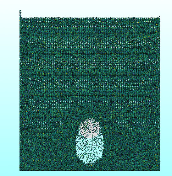

If the internal geometry is not used, the simulation seems generally stable — the particle properties/DEM time step are standard. If the internal surface is prescribed a velocity of 0 (i.e not moving), the simulation will still fail, but can be restarted and it will then run past the most recent restart time. Even very low velocities of the internal geometry (vertical at 1 mm/s) will cause the segmentation fault to occur. The image below is from a case where the internal geometry was moving at 1 mm/s and output at a high dt to show that the simulation is failing just as particles contact the internal surface.

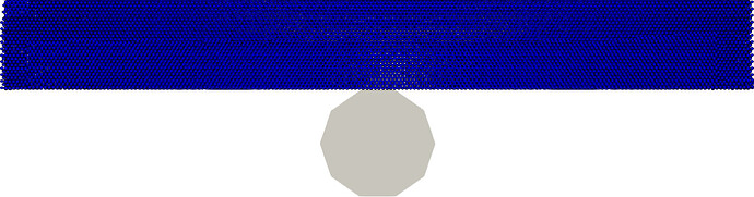

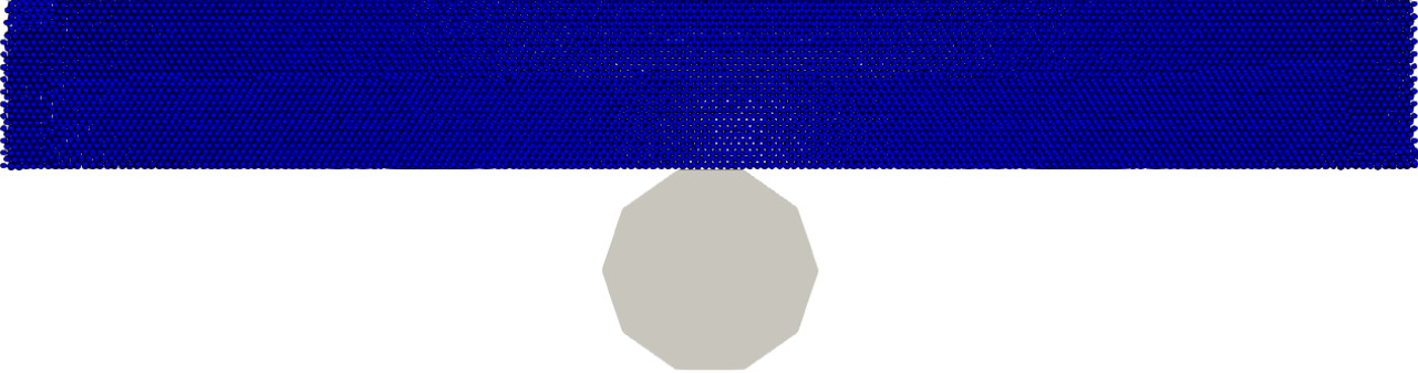

I am not able to reproduce. It ran fine for me in serial and dmp (8x1x16 decomposition) with 25.3 version on Linux:
Moving the stl geometry should only be done with pure granular flow because the fluid phase doesn’t see the moving internal stl surface.
When you are troubleshooting, I would suggest simplifying the model as much as possible until you can reproduce the issue quickly. Here, disable the fluid solver (Model setup pane), set the IC such that it is just above the cylinder and use fewer particles. You also don’t need the other stl files to define a rectangular box since the MFiX domain is rectangular by default. Then you can play with the particle’s properties (Young’s modulus, restitution coef. etc.), use monodisperse particles and see if this helps.
