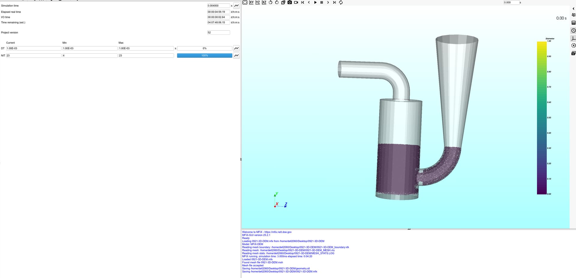

I’m a beginner. While following the content of section 3.10. Procedural geometry in the official tutorial, I noticed that the calculation time became very long after I modified the diameter. I changed the particle diameter from 0.005m in the tutorial to 0.001m. However, there wasn’t much improvement in computation time, whether using SMP or DMP mode.
My CPU is an AMD Ryzen Threadripper PRO 5595WX (64 Cores), and I have 256GB of RAM. Since I don’t have another computer to verify this, I’m wondering if the slow calculation speed is due to the smaller particle size, or if there are some settings that I haven’t configured correctly.

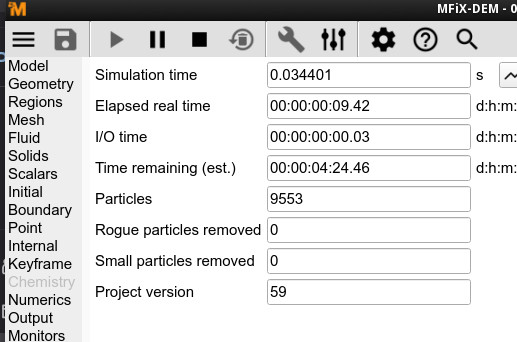

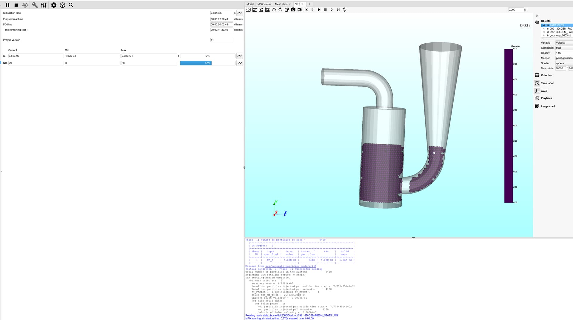

This computer’s performance should be fairly capable. However, the strange thing is that after reducing the particle diameter to 0.001m, the calculation time increased dramatically from tens of minutes directly to several days, as shown in the figure. The only parameter I modified was the particle diameter.

  1. Reducing the particle diameter by a factor of 5 increases the number of particles by a factor of 125. MFiX 25.3 (released today) shows the particle count in the dashboard view:
Diameter 0.005:
Diameter 0.001:
The number of particle/particle collisions to check scales (roughly) with the square of the number of particles. So an increase of 4 minutes to 1 day is not unreasonable (factor of approx 325).

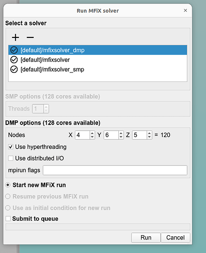

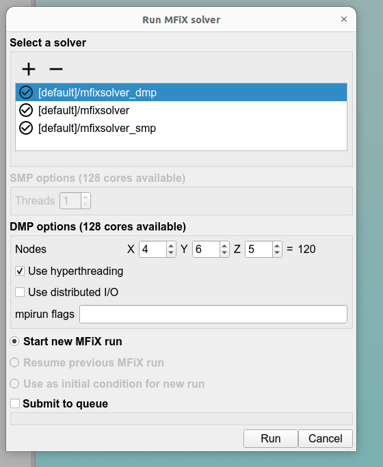

  1. I notice that you are using 120 cores on a 64-physical core system via hyperthreading. This is not always the most efficient since the hyperthreads are sharing CPU cache, memory bandwidth, etc. You may want to compare results with and without hyperthreading.

Thank you for the suggestions. I followed your advice and disabled hyper-threading, then ran the simulation using 16, 32, 48, and 64 cores with the SMP model. However, it didn’t lead to a significant improvement in the run time. It seems the particle count is indeed the primary bottleneck.
