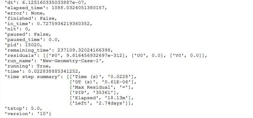

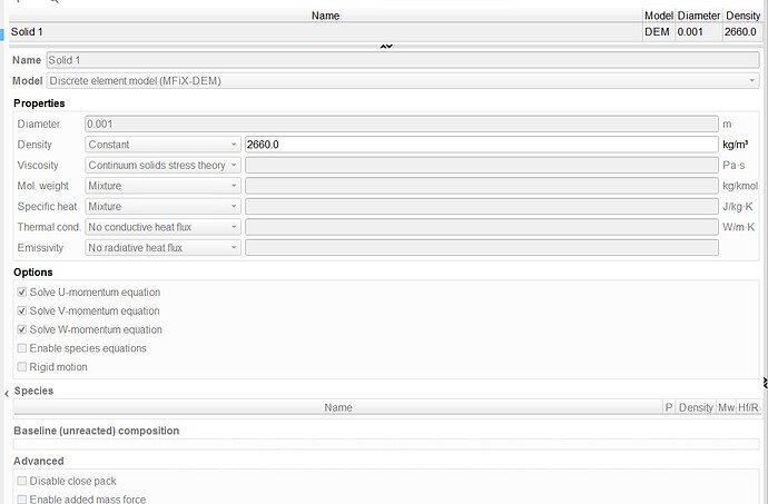

I am trying to do DEM simulation of 1 mm diameter particles.
Seems like it is taking very long time.
I am attaching the screenshots as well as the files.

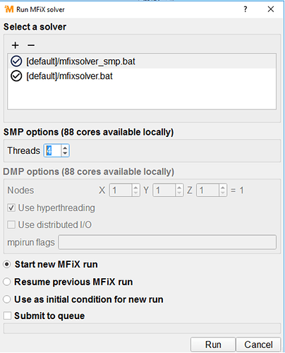

I am running MFiX-DEM on a Windows machine with 88 processors.
How can I make sure that MFiX takes all the 88 processors and run.

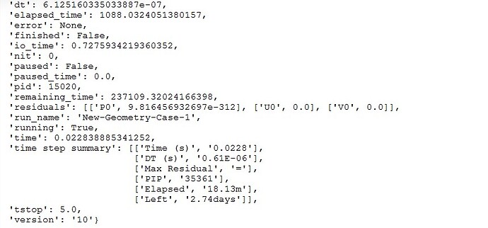

It is showing the time remaining as 2.5 days.
Kindly have a look at the files and settings and let me know if everything has been done correctly.
Thanks and Regards,
Kindly provide me some suggestion how to speed up the simulations.

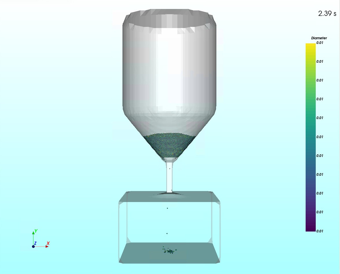

It is going very slow. Also, the particles are very slow to move down.
Thanks and Regards,

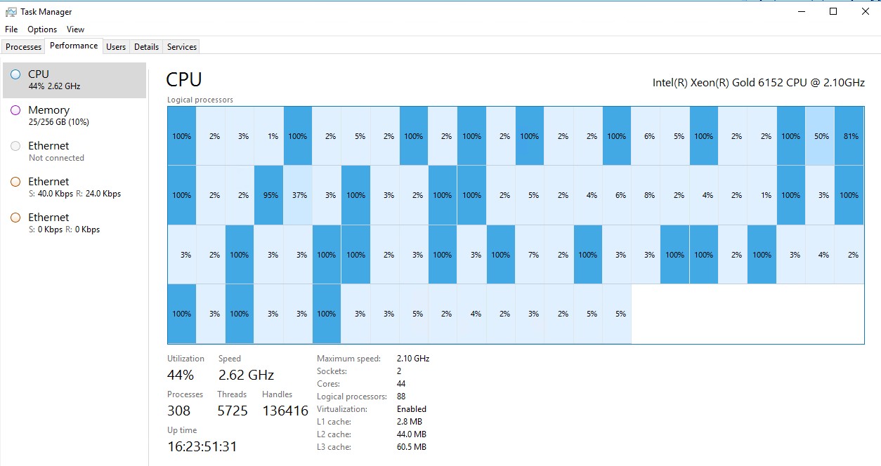

SMP performance is never as good as DMP, and the multithreading support on Windows is not great. If it’s possible to install Linux on this machine and run the case with DMP you may get better results.

Also let me put 88 under Threads since we have 88 processors.

Linux is the preferred environment for running MFIX. Everything is supported on Linux including the GUI, and you can run DMP simulations as well, which tend to offer better speedup than SMP. Installing MFIX on Linux is exactly the same as installing on Windows (Conda package).
I’m not sure if WSL will give as good results as native Linux but you can try it!

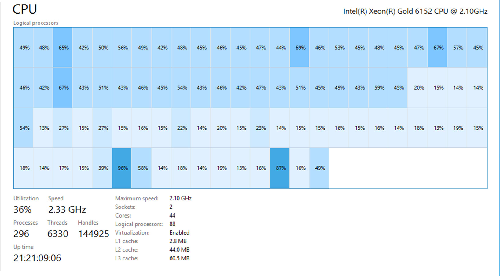

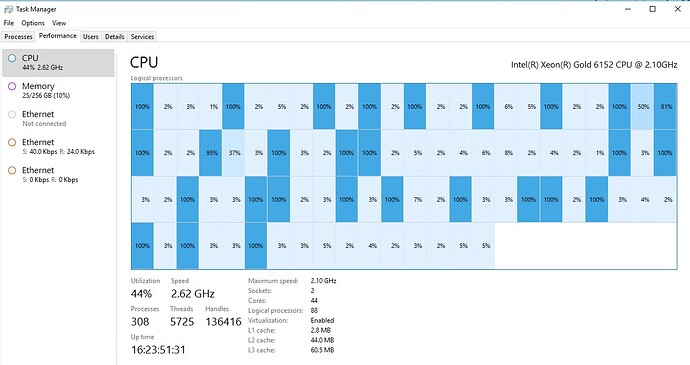

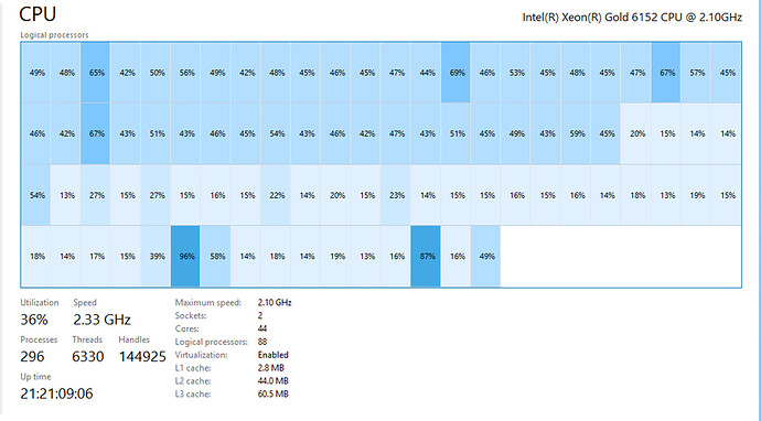

As you can see from the attached figure, it is using 88 processors but the load balancing is not good.

Sadly, throwing more CPUs at a problem doesn’t always help.

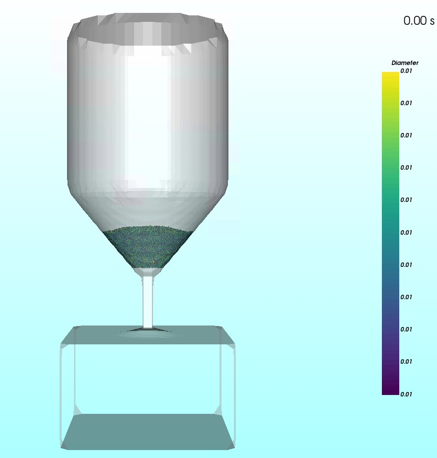

You did not include the particle_input.csv file. If you need further assistance, please attach all project files. Go to the main menu, select submit bug report. This will generate a zip file, attach it to the post. The figure you show looks like you are using particles larger than 1mm since the domain width is 1mm.

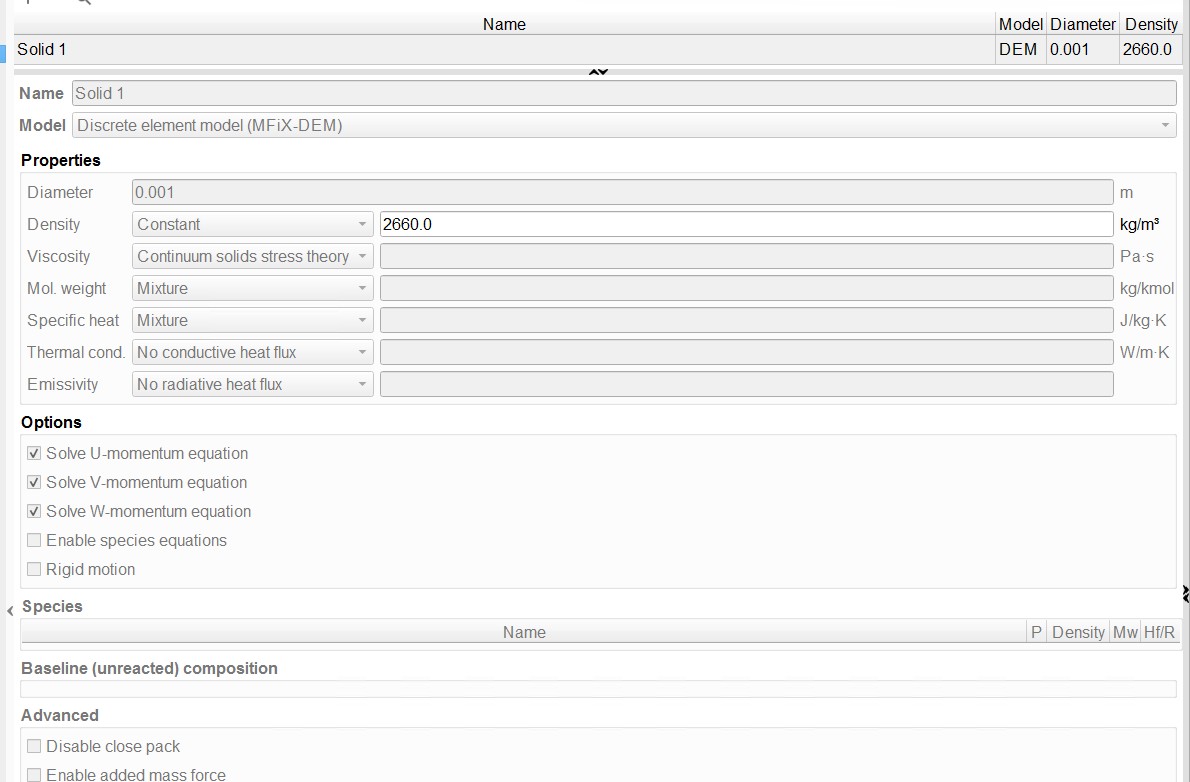

It is running with 1 mm particles. Particles number is 35361.
Kindly let me know if it looks ok.
It is taking a lot of time for the particles to descend down.
Thanks and Regards,

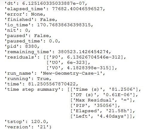

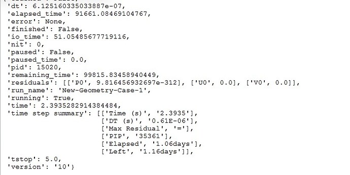

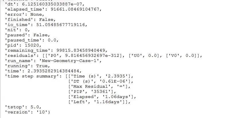

I am also attaching the simulation status.
The time step is very low. 0.6e-06 seconds.
Anyway to increase that ?
Kindly let me know.

You could expect more even cpu load distribution if your geometry also was very uniform. Yours is not. I believe the load is distributed solely done by chopping the mesh up evenly, and if nothing happens in one of these chunks, then cpu will not be used either.

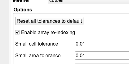

Did you try to enable the array reindexing?
Thank you.
No I have not tried array indexing.
I will try that one and let you know.
