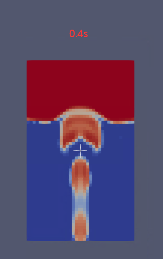

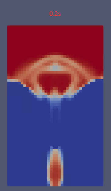

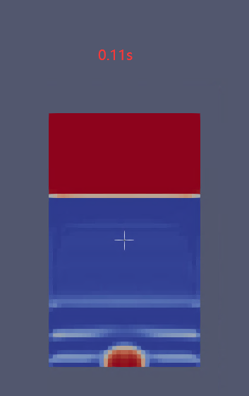

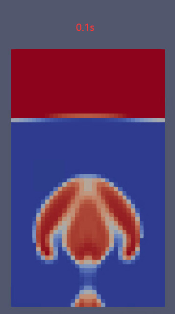

I tested the new feature “define ramp for velocity” published in the version 24.1. But it seems the gas flow stopped after a period of time, as shown below.
