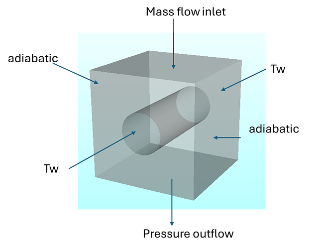

I am performing heat transfer simulation for pure granular flow in MFIX DEM.
I want to introduce constant temperature at front and rear wall, adiabatic wall for the right and left wall.
I don’t want to set any temperature for the fin wall. Since the heat should get conducted (diffused) by fin wall from the front and rear wall. This is occur due to conjugate heat transfer. I don’t know whether Mfix has the capability to do this.
  1. Can you please help me out in setting up conjugate heat transfer?
  2. Also the wall material is different from particle material. How to set up different thermal properties for the wall?
Thanks @jeff.dietiker
MFiX does not have the capability to do conjugate heat transfer.
