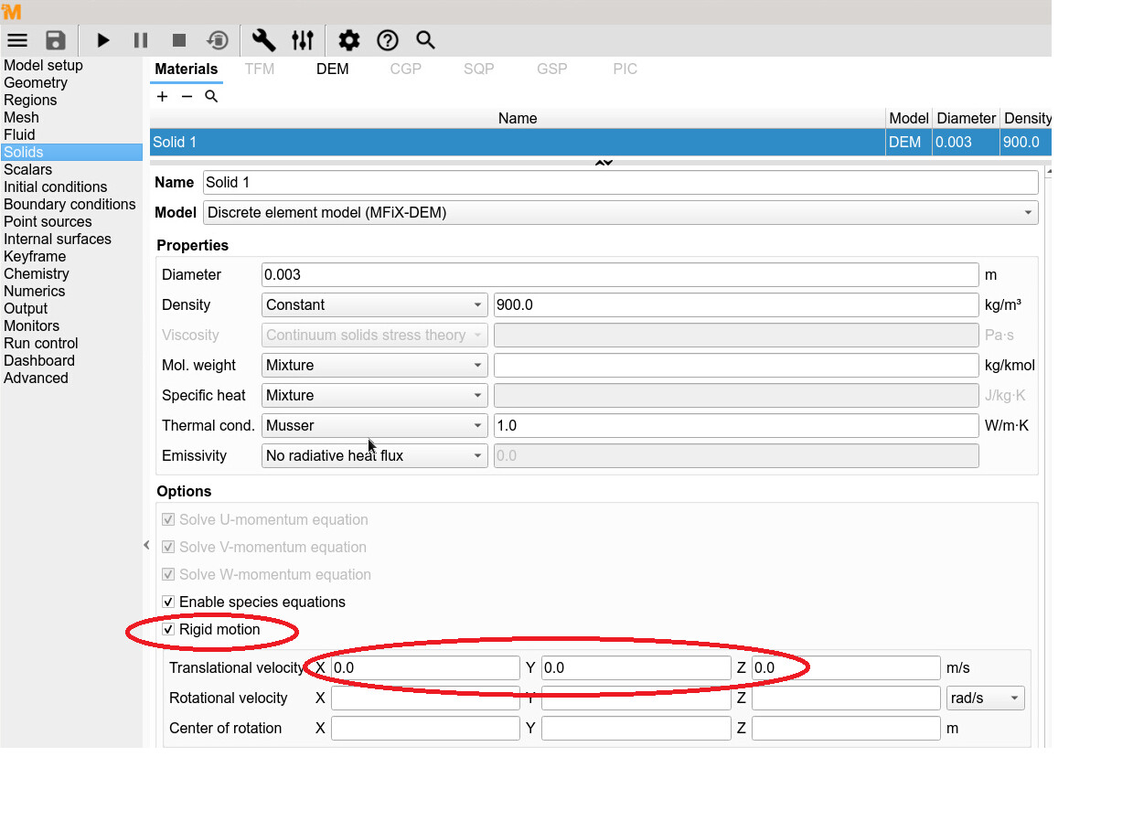

I am assuming this is with DEM.If you use a particle_input.csv file as initial condition, you can set the particles in a given solids phase as stationary by selecting “Rigid motion”, and specifying a zero velocity:
If you initialize the particles in an IC region, this doesn’t work. It will be fixed in the next release, but you can use the attached file with the 25.3 release (copy in your project directory and rebuild the solver).
