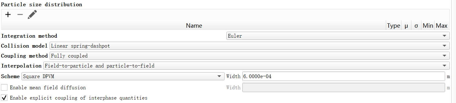

I set the DES_INTERP_ON as true,and didn’t specified the heat of reaction on CHEMISTRY
