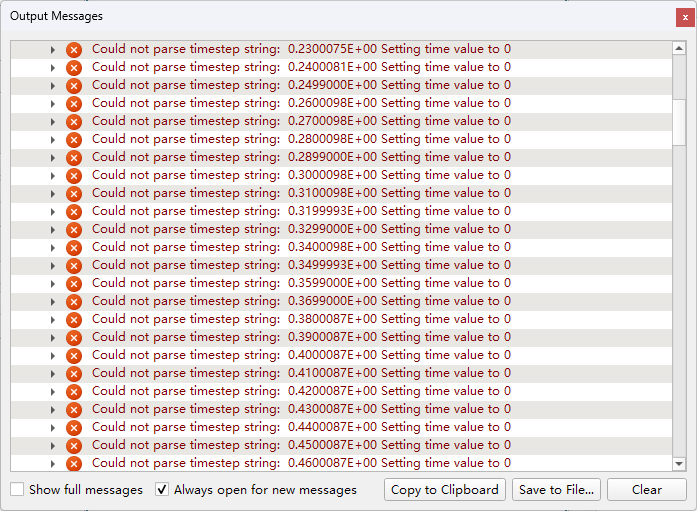

Import .pvd file into paraview and error occurred in 7.2.1 Running Paraview
I have followed this postprocess instruction of fluid_bed_dem_2d to output .RES and .pvd files but error occurred when I imported particle .pvd files into Paraview software, here are error files(Error.txt) and mfix bug report zip, could someone give me some help? Thank you! I thought if I can reset this fluid_bed_dem_2d tutorial in Mfix for I seemed to make some undesirable changes in this tutorial

There is an issue with the latest Paraview version (6.1), and Charles has a fix for it
You can also use previous versions of Paraview that accept the extra space in the timestep string.
