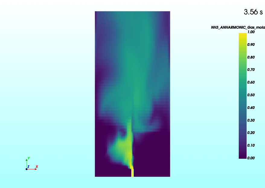

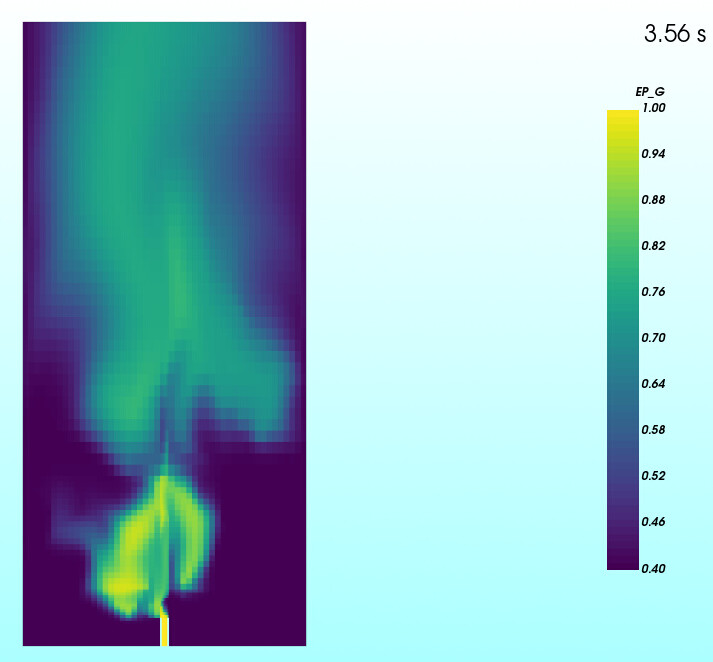

The initial and boundary conditions in my example are completely symmetrical. However, during the calculation, there was uneven gas-solid flow, as shown in the figure, which caused a deviation in the results of gas diffusion and easily formed a flow dead zone, which is difficult to recover in subsequent calculations. I would like to ask everyone about the reasons for this situation? My guess: There are issues with the time step and grid settings.

I ran in DMP and I do not see that dead zone:

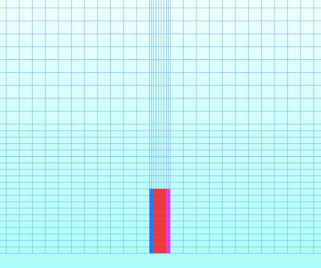

The grid spacing has large jumps in x and y direction:
You should try to use a smooth transition instead.
