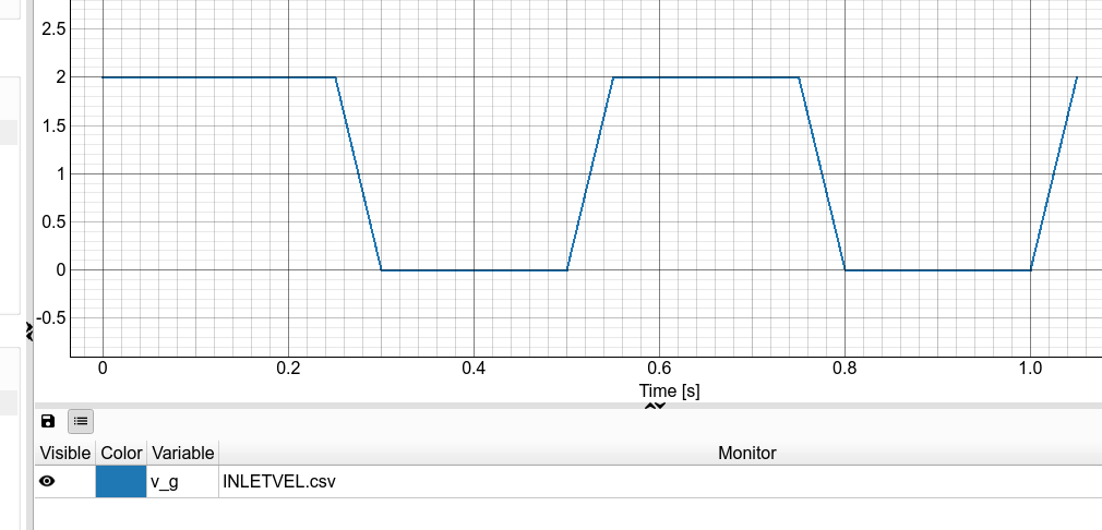

Keyframes velocity inlet broken in latest version (25.2.1), works in earlier

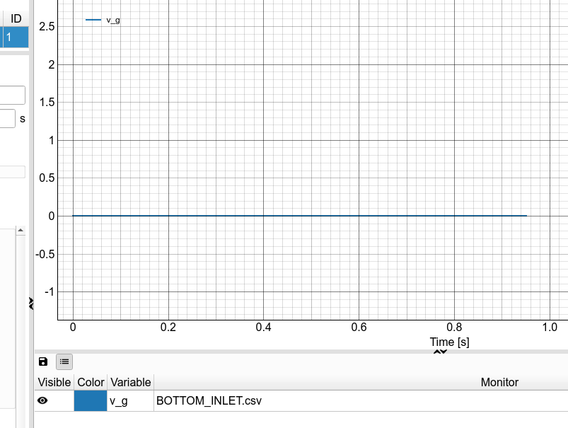

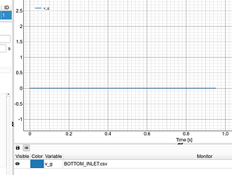

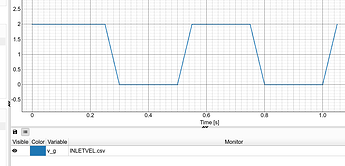

Easily reproducable by running the pulsating fluid bed example. The inlet velocity should change as per the first graph, but is constant zero, shown in the second image.

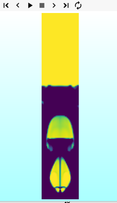

(This particular keyframe example produces quite beautiful results, bottom image, when using a version that works.)
Thanks for the bug report, we will fix for the next release.

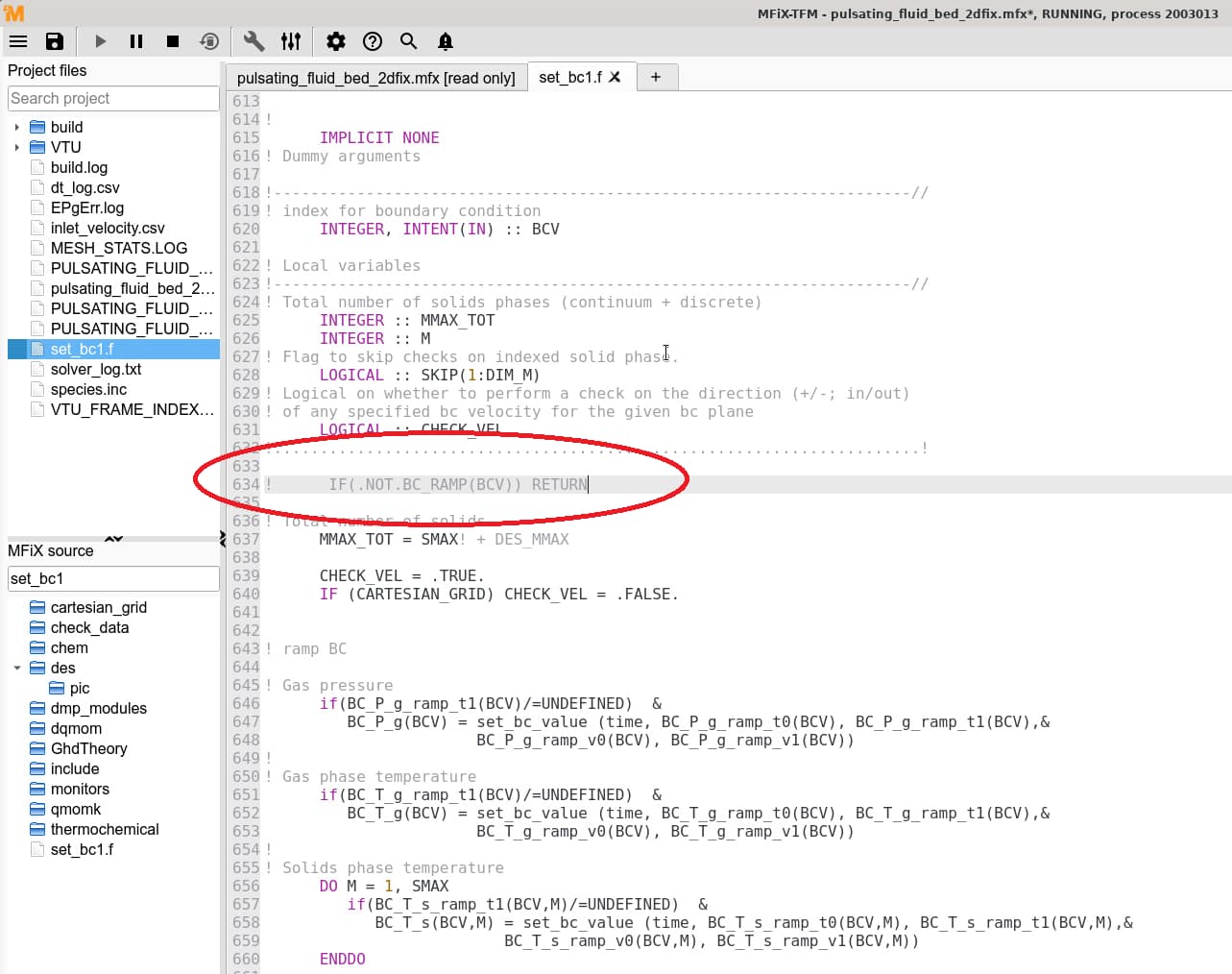

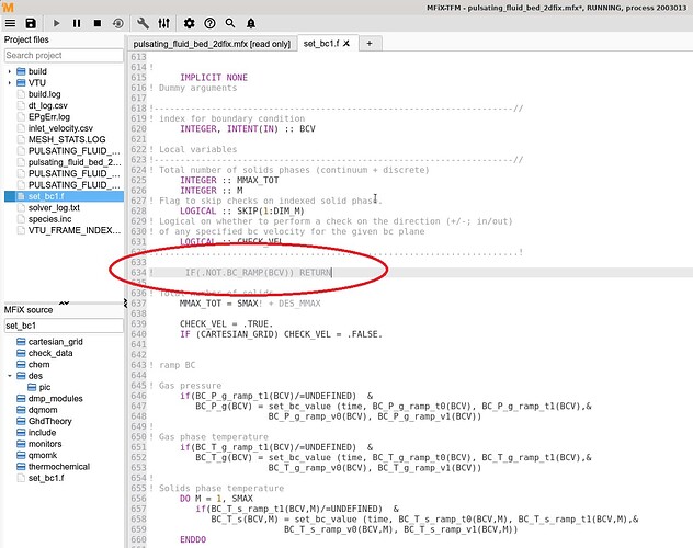

Please try this temporary fix until the next release:
  1. In the GUI Editor, open set_bc1.f (Click “Copy” at the top-right corner to copy the file to the project directory.
  2. Go to line 634 and comment it out. Save the file.
  3. Build the custom solver.
  4. Run the simulation with the custom solver (select [project]/mfixsolver in the list of solvers).
