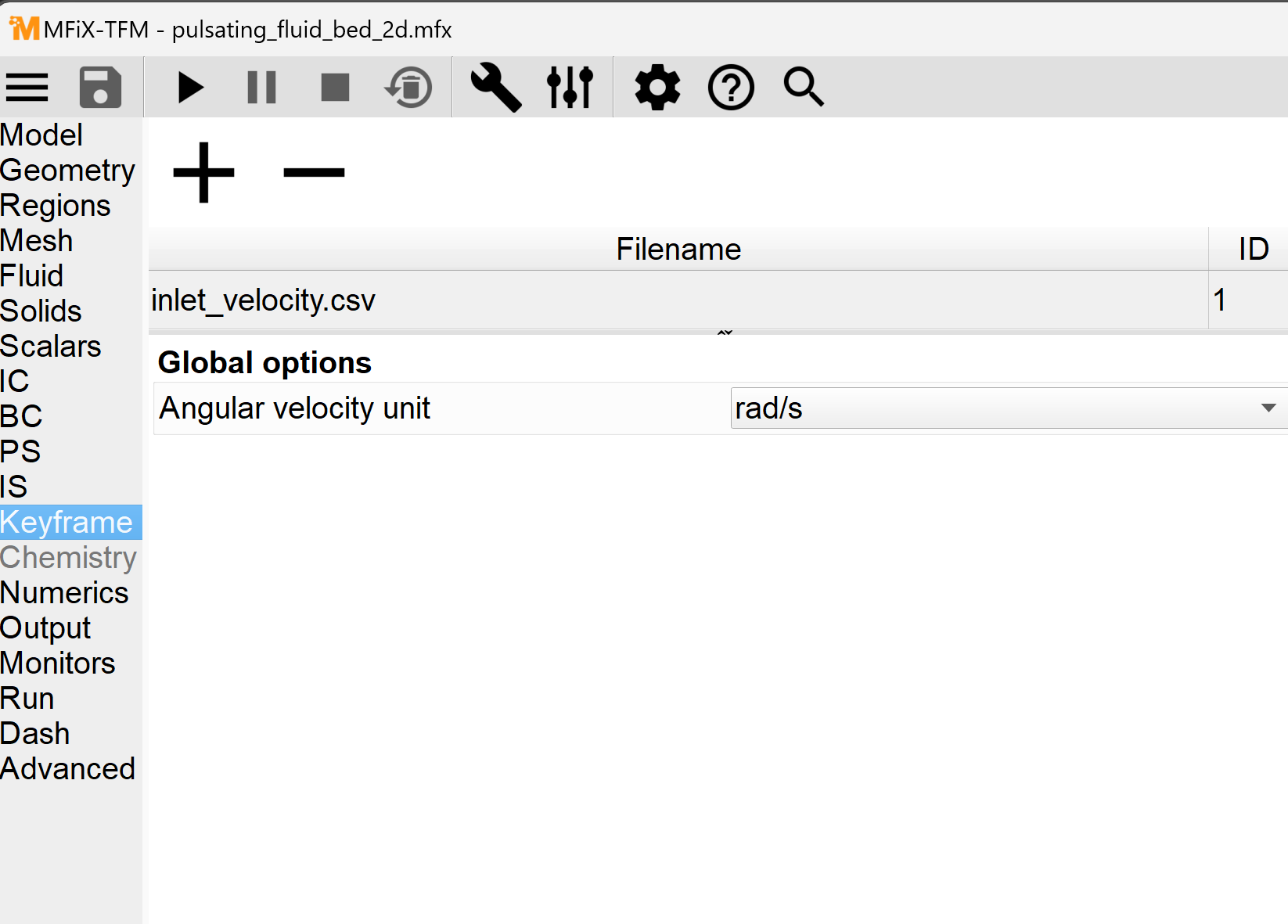

When I load the TFM MFIX tutorial
I cannot change the parameters of the inlet_velocity keyframe (steps, linear, what property is read) etc. It appeared once and then never again in all tests I tried. I had to manually change them in *.mfx. Should be a minor fix but an useful one :). I added the same temporal BC in another sim, and had the same issue. Best, E.
pulsating_fluid_bed_2d.zip (28.7 KB)
Sorry, the keyframe pane is broken, we will fix in the next release, thanks for reporting the bug!
Thanks Eric. This will be fixed in 25.2, in the meanwhile it’s a 1-line fix if you want to patch the file yourself.
