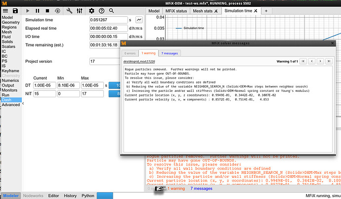

Running your case with this version, the message looks like this:
This does not cause the solver to exit, the particle is removed, and some suggestions are given.
