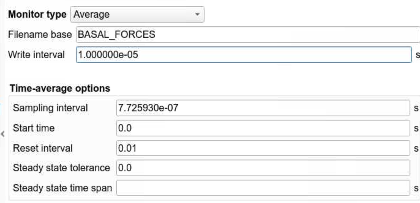

Hi,
I am attempting to write data to a monitor file at a rate of 1.0E-5 s. The above settings produces two CSV files: one file containing what I am assuming is instantaneous data, the other, with the suffix _tavg, produces time averages using the 0.01s averaging interval. Nevertheless, it seems that the instantaneous data is only written at a rate of 0.01 s (the fluid timestep, whereas the solid timestep is ~7E-7). Is the write interval constrained by the fluid timestep? Or am I not understanding the monitor setup?

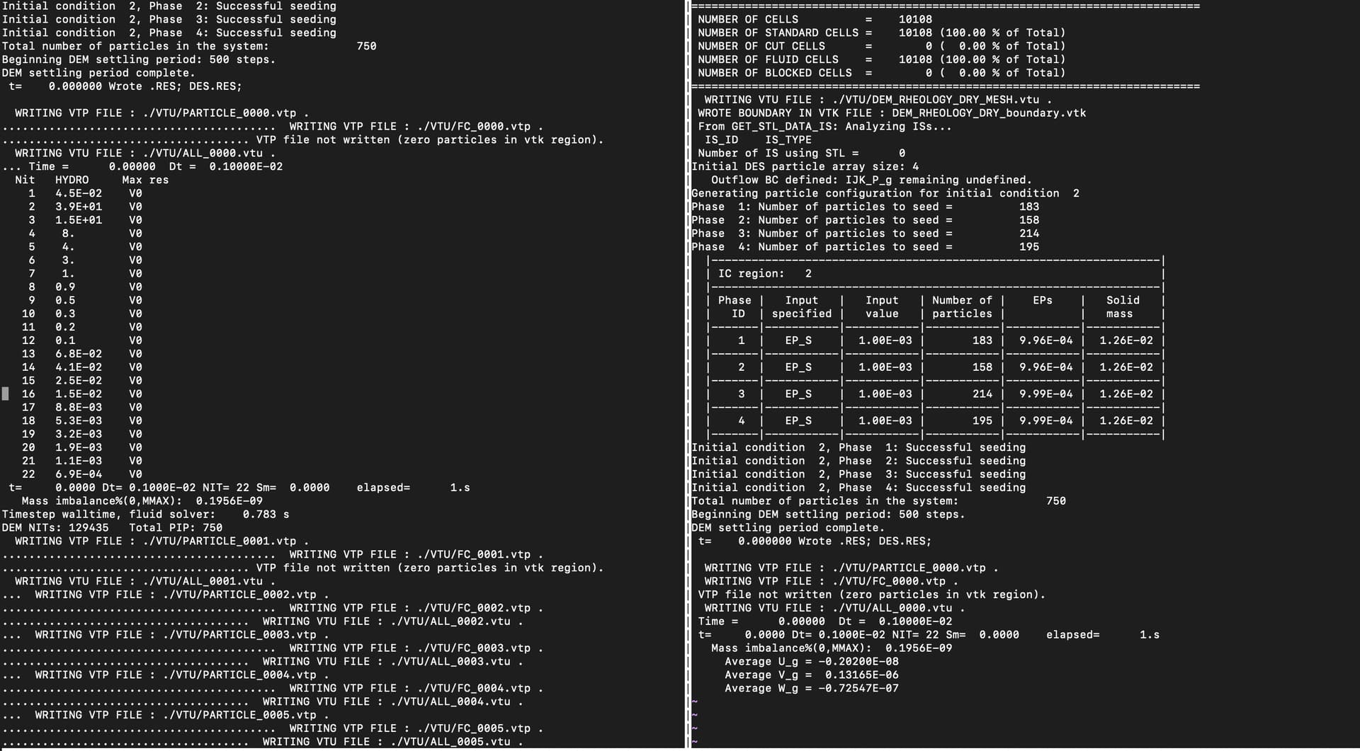

Ok maybe perfectly is the wrong word. this significantly alters what is written to *LOG. I can no longer see the progress of the simulation, i.e., fluid and dem number of iterations, solver wall times, etc. Currently looking into how to recover what I would consider ‘normal’ behavior.
regardless, the fix above does what I was looking for in the original post.
-P
Can you see the progress of the simulation in the GUI dashboard?
It is the same.
I see the first iterations (t = 0.0). After, I only get indications when VTPs are written. See attached for examples of what stdout (left) and the LOG (right) files look like.
