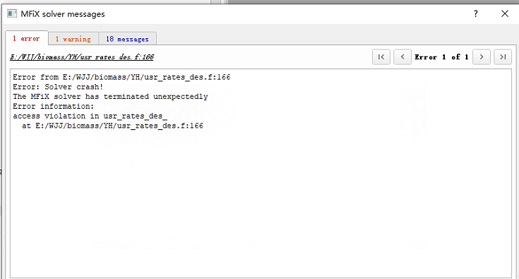

When I want to save the following project, the warning "Version control operation failed: module ‘git’ has no attribute 'refs’s " appears , and when I want to run the case, I get the solver crash error , I don’t know how to fix them, can you help me check what’s wrong? Attaching my case here.

The second problem is an access violation in your UDF. Sometimes building the solver in “DEBUG” mode will help track these down. Also, if you have access to a Linux host (either real Linux or via a VM on Windows) you will find it easier to debug UDFs since you will have access to better diagnostic info on Linux.
Line 166 of usr_rates_des.f is
      ReactionRates(IJK,lB:uB) = ReactionRates(IJK,lB:uB) + DES_RATES(:)
so something there - either the IJK or the ib:ub bounds is outside the valid range. In the absence of a good debugger, you can try adding PRINT statements to see what’s going on. But I think the problem is here:
This is a fairly common error - failing to allocate the ReactionRates array.
