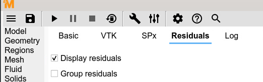

Go to Output> Residuals and turn on “Display residuals”:
