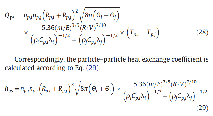

also attached is the particle-particle heat transfer coefficient, kindly look at it.

The solids-solids heat conduction between two different phases is neglected in TFM. I don’t know where you got Eq. 28-29 from but it looks like DEM.

Equations 28-29 used the heat transfer coefficient between the two solid particles in the computation study and found in the article which is attached herewith.

As I said earlier, the solids-solids heat conduction between two different phases is neglected in TFM, there is only conduction within a given solids phase. The Syamlal report does not discuss heat transfer, only drag. Eq. 28 and 29 are not from the Syamlal report.

If your goal is to run TFM with solids-solids heat transfer (between different solids phases) to reproduce the article’s results, then you should use Fluent. The equations you are referring to is what Fluent solves, not MFiX.

Yes, there is a particle-particle conduction term in MFiX DEM, not MFiX TFM.
