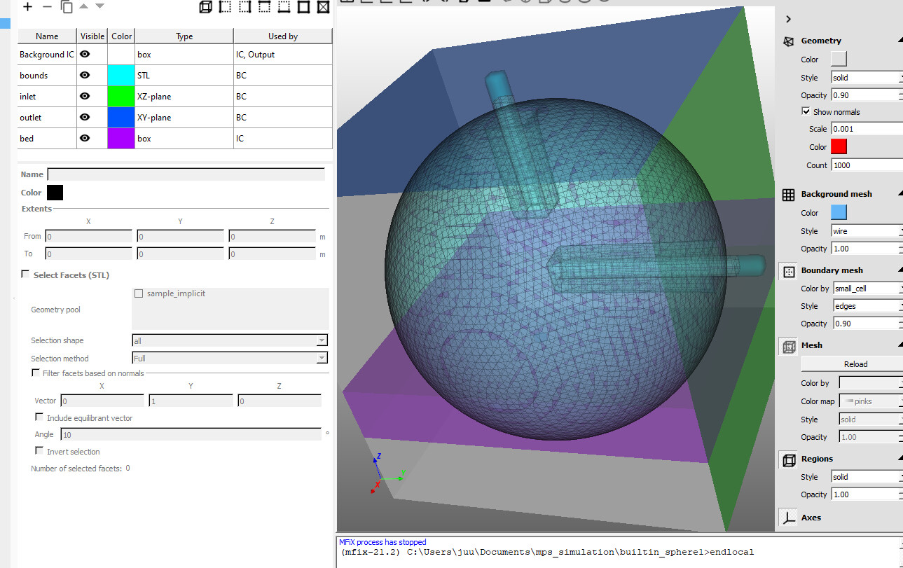

I have built a TFM simulation project. But it is constantly encountering the above popped error though when it is running the remained time shows.
Another phenomenon is that though I have set up the initial volume fraction of particles in some regions, they are not visualized at the very beginning as the same as that of other tutorial examples with similar configuration and simulation method. I would quite appreciate if you could help me check my .mfx file, and indicate its potential errors if they were not bugs. Thank you.

Thank you Charles, it is weird that everything seems normal when the simulation begins. The mesh seems normal as well. But after 1-2mins, it pops up the same error as follows.
And I can not find conspicuous errors in generated mesh for bounds and regions either. Thank you.

The boundary mesh is beautiful, but the DT<DT_MIN problem happens persistently.
This time I change the density of gas, and the simulation lasts for 0.028s and DT<DT_MIN happens again.
