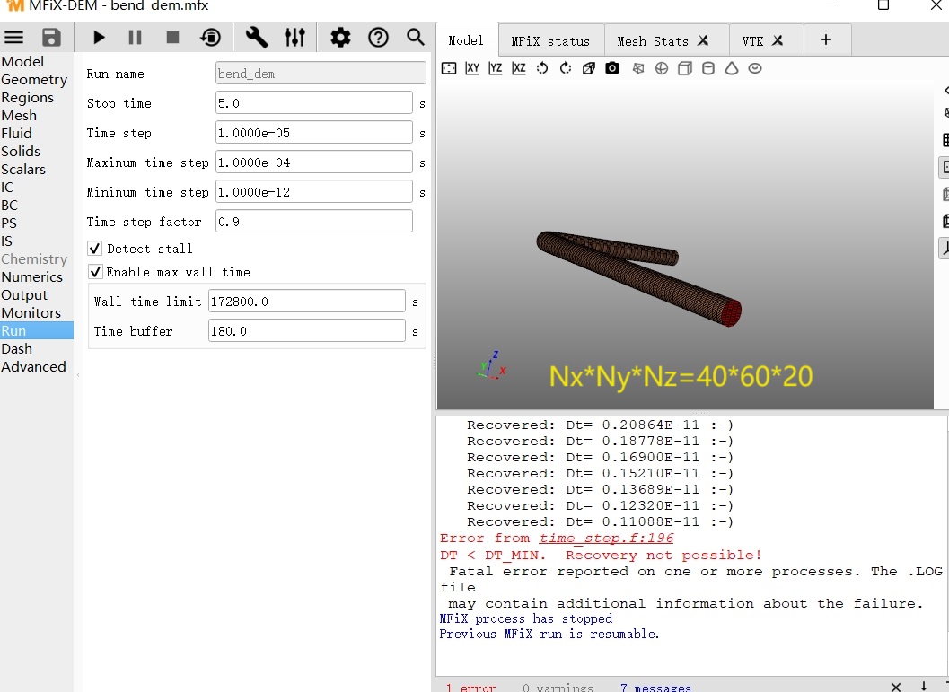

Initially, I used a computational grid of 40x60x10, and MFIX provided results for both the flow field and particle motion, although the results were quite rough. When I attempted to refine the grid, specifically increasing the grid in the z-direction from 10 to 20, the simulation could not proceed. The error message indicated “dt < dt_min”.
I have checked the CFL number, and according to the grid size, time step, and inlet velocity, dt_min should satisfy the CFL condition. Even after reducing dt_min to 10^{-10}, the simulation still failed to run.
Could any experts provide suggestions on how I can successfully perform calculations with a finer grid? Below are the simulation parameters I used. Could you check if there is anything wrong with them?
