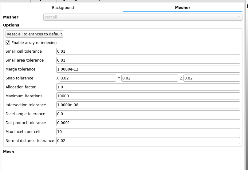

My model is running with the following error:
This error seems to occur after I add van der Waals forces to the particles, without van der Waals modeling there is no such reported error.
I have tried changing the mesh parameters as shown below, but found that it still doesn’t work. Please tell me what is the reason for this error, here is my case hope you can give me some advice, thanks!
