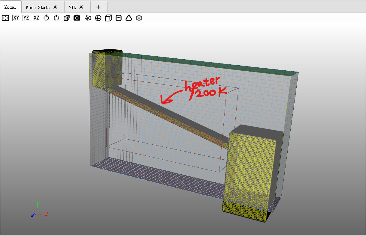

the geometry is below,
And ,i hope the cantboard’s temperature be 1200K, while the other walls stay the No-flux type.
so ,the particles should have a teperature rise when falling down from the board.----but it seems don’t work.
Is it the BC i set up wrong?
Your Heater region overlaps the wall region, so you have a conflict in the BC. You need to separate the regions so the STL files don’t overlap. I would slice the wall region twice to get a wall region upstream of the heater and another wall region downstream of the heater.
