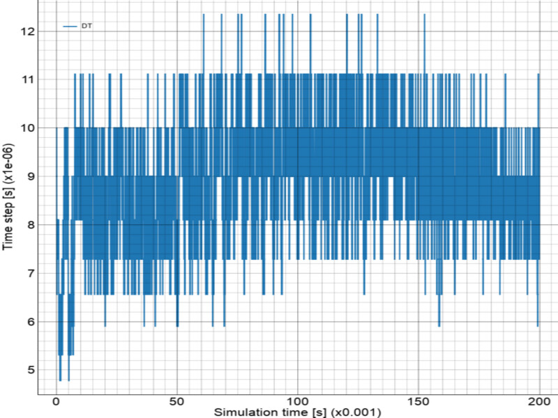

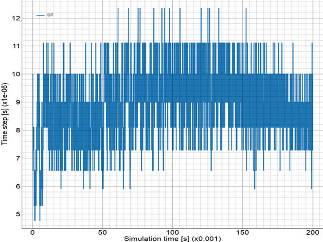

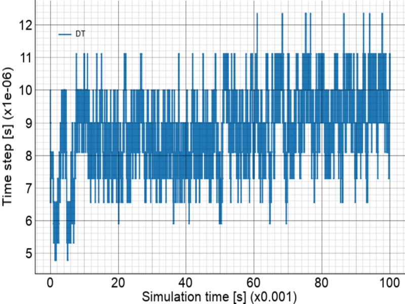

Here’s a plot of DT over a 200ms run:

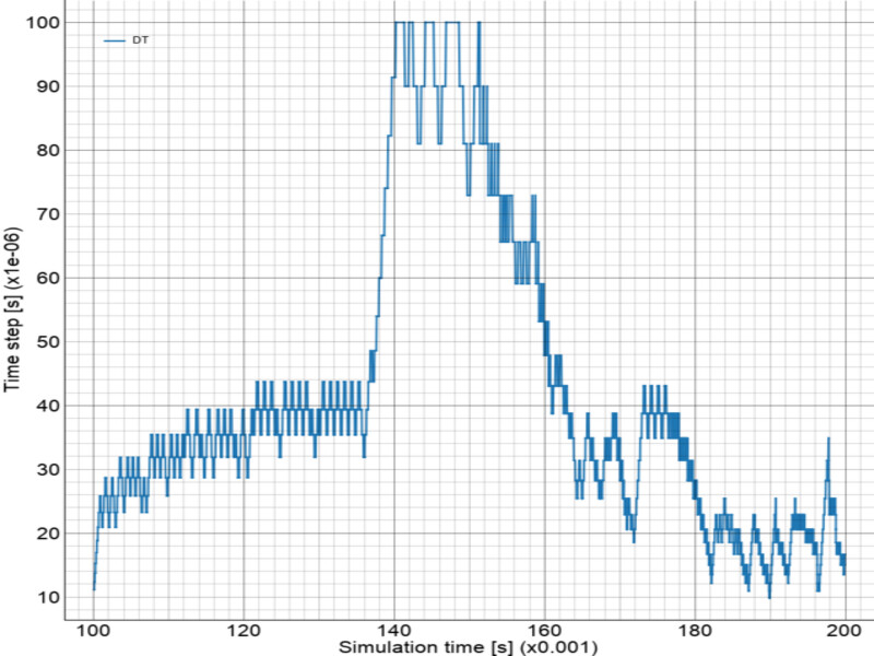

Here’s the plot when I stop at 100 ms and restart:
There is a sharp increase in DT after the retart (but not immediately). We’re looking into this and will let you know what we find.

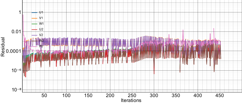

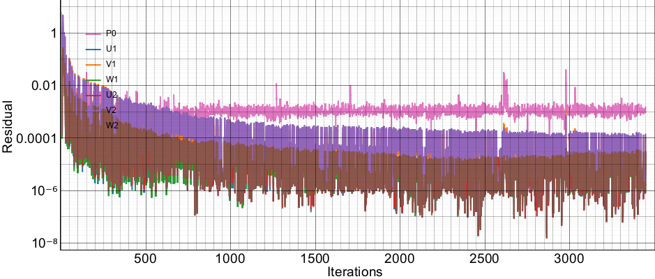

Still not 100% sure what’s going on but here’s some more data. I plotted residuals (fluid pressure and solids velocities), using a log-scale on the Y axis
Here’s what the residuals look like over a 100 ms run:

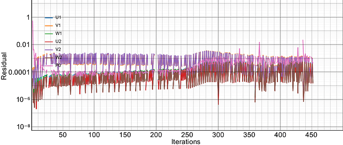

And here’s what I see if I stop after 50 ms then restart:
0-50ms:

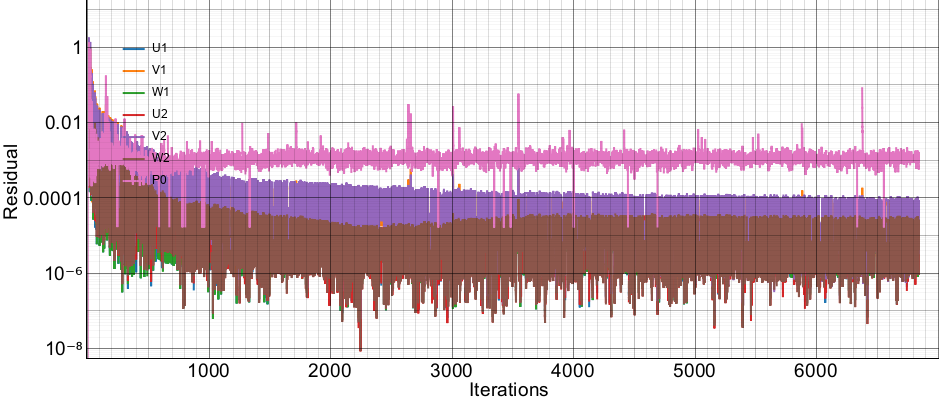

50-100ms:
The issue is the turbulent length scale is not saved in the restart file. This is a bug, thank you for pointing this out. It will be fixed in the next point release. In the meantime, copy the two attached files to your project directory and rebuild the solver. Please let us know if this works for you. I cannot comment on whether a mixing length turbulence model is appropriate here nor if the turbulent length scale of 1m is appropriate, but this should address the time step change you are seeing upon restart.

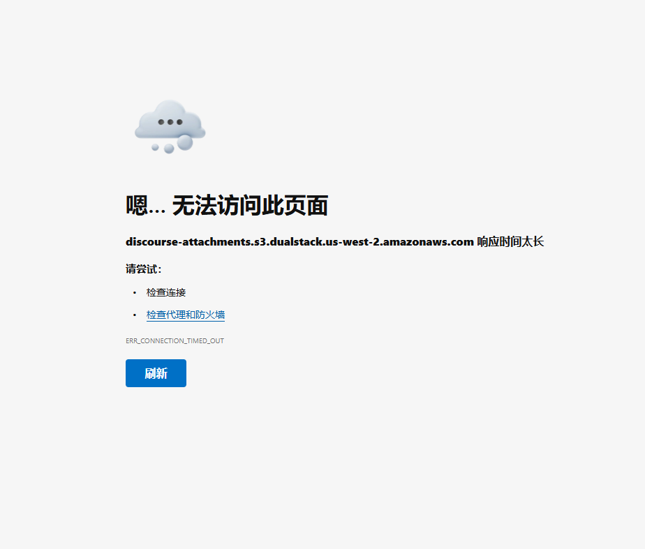

I am unable to download the two attachments included in your solution. Could you please send the two attachments to my email address: [deleted]? Thank you very much!
What happens when you click the download link? I’ll try to fix it if you tell me what the error is.
Clicking on the attachment results in the situation shown in the picture.
The picture shows “This page cannot be accessed”.
Interesting, the error is “Connection timed out”, not a permissions issue. I’ll try to look into this. In the meanwhile I will email you the files.
