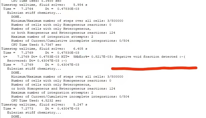

yesterday,I ran this case again,This is the output time.You can see the speed is getting slower and slower. This is even more obvious after ALL_20 (simulating the real time of 10s).It even takes 3 hours to compute 1s at last. I used 32 processes in parallel.

dT is steadily decreasing during your run, which is why it’s slowing down. The time used by the chemistry solver also seems to increase after about 10.5 s, I’m not sure of the exact reason for this but I don’t think it’s the main reason for the slowdown.
MFiX will decrease the timestep (dT) when the simulation is failing to converge.
Notice that the log file contains a large number of messages of the form:
t= 11.5780 Dt= 0.1501E-03 NIT= 80MbErr%=-0.2580E-03: Run diverged/stalled :-(
that :-( means that the solver is not happy.
