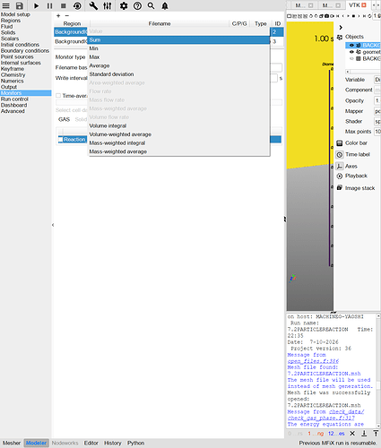

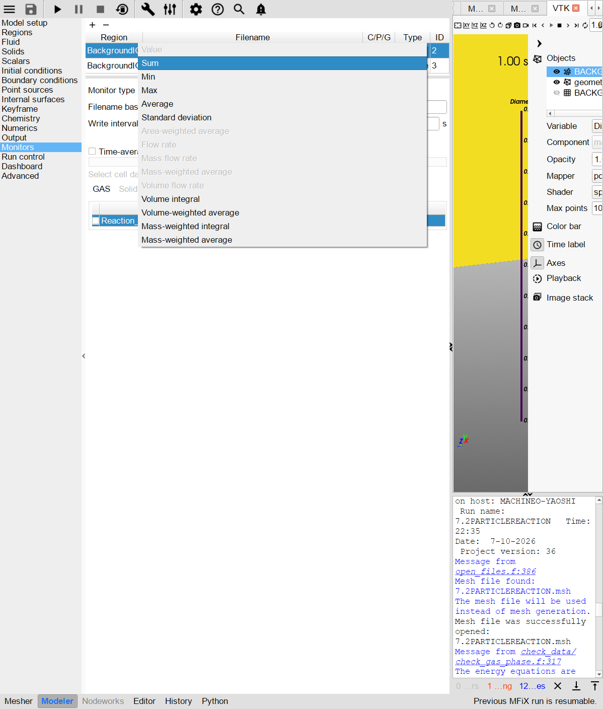

②When setting up monitors, why is the “value” option unavailable? (In the “Cell” settings, the “value” option is greyed out , while in the “Particle” settings, the “value” option is missing entirely)

  1. For a cell monitor, the “value” type is only available for a point region. This will monitor the value of a single cell located at the point region. The “value” type is not available for particle data, because particles typically do not stay at a single point during a simulation. Now if you only have a single particle, you can define a region that covers the entire domain and use a monitor type of “average” (you can also use min/max or sum since you only have one particle, these are all equivalent).
