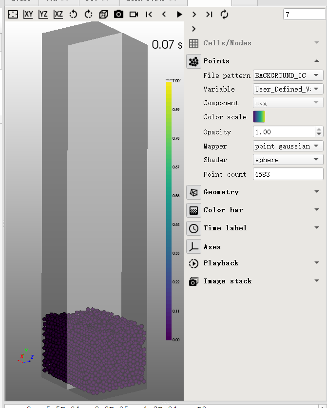

Not sure, looks like you are setting a wall temperature. I see non zero values of des_usr_var(3) near the wall:
But it’s zero in my vtk,What is your mfix version?
It’s really strange.
I used the latest 21.4 on Linux
