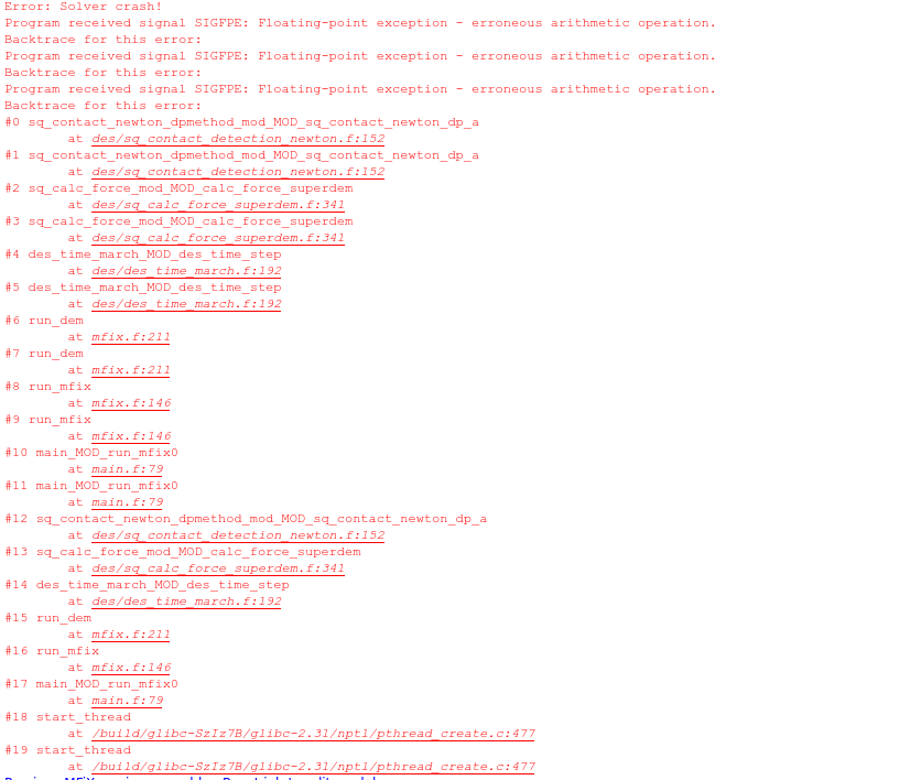

which creates a sq_input.dat with 4500 identical lines - but running this case I get:
Error: Solver crash!
Program received signal SIGFPE: Floating-point exception - erroneous arithmetic operation.
Backtrace for this error:
#0 sq_properties_mod_MOD_sq_volume
at des/sq_properties.f:675

But alas, after a while there is a new error:
#0 wrap_pow
at xpow.c:31
#1 sq_equivalent_radius_mod_MOD_sq_gradient
at des/sq_equivalent_radius.f:53
#2 sq_contact_newton_dpmethod_mod_MOD_func_dp_a
at des/sq_contact_detection_newton.f:949
#3 sq_contact_newton_dpmethod_mod_MOD_sq_contact_newton_dp_a
at des/sq_contact_detection_newton.f:267
#4 sq_calc_force_mod_MOD_calc_force_superdem
at des/sq_calc_force_superdem.f:341
#5 des_time_march_MOD_des_time_step
at des/des_time_march.f:192
#6 run_dem
at mfix.f:211
#7 run_mfix
at mfix.f:146
#8 main_MOD_run_mfix0
at main.f:79
we are trying to compute x*x where x=6.6205546496795669e+154 and it’s an overflow. It’s also Friday, I will return to this topic next week

With the correct diameter value in the file (0.012787997374897409, as computed by the superquadric designer) the simulation crashes almost immediately with:
#0 sq_calc_force_mod_MOD_calc_force_superdem
at des/sq_calc_force_superdem.f:377
#1 des_time_march_MOD_des_time_step
#2 run_dem
at mfix.f:211
#3 run_mfix
at mfix.f:146
#4 main_MOD_run_mfix0
at main.f:79

Disabling the FPE trap in xpow and allowing it to return inf:
Now we’ve got a new backtrace:
#0 sq_rotation_mod_MOD_qmatrixrotatevector
at des/sq_rotation.f:345
at des/sq_equivalent_radius.f:80
#4 sq_calc_force_mod_MOD_calc_force_superdem._omp_fn.0
Core was generated by `/home/cgw/mambaforge/envs/mfix-git/bin/python -m mfix_solver.pymfix -d /tmp/n2d'.
Program terminated with signal SIGFPE, Arithmetic exception.
#0 0x00007f4b2a8fcd3d in sq_rotation_mod::qmatrixrotatevector (qrot=..., x_frame_1=..., x_frame_2=..., ixg=2)
at /home/cgw/mambaforge/envs/mfix-git/share/mfix/src/model/des/sq_rotation.f:345
345 & *X_frame_2(2)+Qrot(3,1)*X_frame_2(3))
[Current thread is 1 (Thread 0x7f4b26b046c0 (LWP 17346))]
(gdb) list
340 ! its transpose
341 !
342 ! Rotate the vector "X_frame_2" from the local frame (2) to the
343 ! global frame (1)
344 X_frame_1(1) = 2.D0*(Qrot(1,1)*X_frame_2(1)+Qrot(2,1) &
346 X_frame_1(2) = 2.D0*(Qrot(1,2)*X_frame_2(1)+Qrot(2,2) &
347 & *X_frame_2(2)+Qrot(3,2)*X_frame_2(3))
348 X_frame_1(3) = 2.D0*(Qrot(1,3)*X_frame_2(1)+Qrot(2,3) &
349 & *X_frame_2(2)+Qrot(3,3)*X_frame_2(3))
(gdb) p qrot
$1 = ((0.49903154015346318, -0.0007951998096093725, 0.031094848276286433) (-0.028471787774220762, 0.18959288376215444, 0.46178338615382208) (-0.012525144031196185, -0.46265960066123457, 0.18918037605149429))
(gdb) p x_frame_2
$2 = (-inf, -inf, inf)
Reducing the number of particles from 4500 to 45 - this is probably a good idea for debugging because it speeds things up considerably. Here’s another movie, with the colors corrected (negative y-velocity, downward, is blue/purple, positive y-velocity is yellow). I used a shorter VTK write interval to capture more detail. It starts off slowly but gets pretty wild when the particles hit the bottom and start spinning around like crazy!
The error now is in a new place:
#0 0x7fc530f8f5cf in ???
#1 0x7fc4e4688e64 in __sq_calc_force_mod_MOD_calc_force_superdem._omp_fn.0
at model/des/sq_calc_force_superdem.f:377
Next things to try:
- disable ALL overflow checks (not just in
xpow.c) - try m=6 as Xi suggests.
With all FPE (overflow/zero-division) checks disabled (invalid operations will result in NaN or +/-Inf as appropriate, per IEEE754)
This is quite interesting - it took about 20 minutes to simulate 2 seconds, and there were no crashes, just some overlap is too big! messages.
Thes disc-shaped particles are spinning very fast. As entertaining as it is to watch, I’m not sure how physical it is. It might be correct. Particles tend to find their happy place and hover there, spinning madly, but eventually they drift off or are hit by another particle.
If you look closely, going frame-by-frame, you can find a few things like this:
two particles have completely intersected in a physically impossible manner. This is perhaps to be expected, given the high spin rate - we might have just missed the collision between them. dt is 0.01 sec, it’s possible that reducing max_dt would help with these overlaps (at the cost of slowing down the simulation). But since FPE checks are disabled, this was non-fatal - the simulation continued regardless.
This tells me that perhaps we need to reconsider the way we handle FPE’s are handled in MFiX. Disabling them altogether seems unwise - but for sections of code like the SQP code where we know large values are common (due to corners and other singularities) it might be easier to disable FPE checks than to rewrite the code to avoid doing things like (huge_number) ** 2 - checking all the inputs to all calculations would be a lot of work and could also slow down the code substantially.
Or perhaps we could add a control to the Numerics pane to enable/disable the various type of FPE check.
