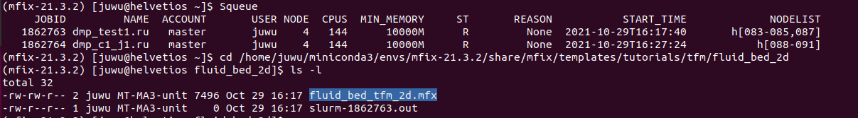

Thank you Jeff, I tried the simplest project fluid_bed_tfm_2d.mfx with same same procedure as the above under SLURM but no output results are generated as well. But this simple example can be run with default command “mfixsolver -f fluid_bed_tfm_2d.mfx” and generate the expected outputs. It is so weird. I hereby attach the snapshots of my .run file for SBATCH.
Hi Ju - You should try to get help from your local computing department, since this seems to be an issue on your cluster. But if you want us to try to help, please attach the slurm.out file. Thanks.
Thank you Charles, I hereby attach the .run and .out corresponding to the snapshots above. And I also snapshot the targeted project folder that you can see there are no output results generated up to the end of preset one-hour simulation time.
$ cat slurm-1862763.out
srun: Job step aborted: Waiting up to 32 seconds for job step to finish.
slurmstepd: error: *** JOB 1862763 ON h083 CANCELLED AT 2021-10-29T17:18:09 DUE TO TIME LIMIT ***
slurmstepd: error: *** STEP 1862763.0 ON h083 CANCELLED AT 2021-10-29T17:18:09 DUE TO TIME LIMIT ***

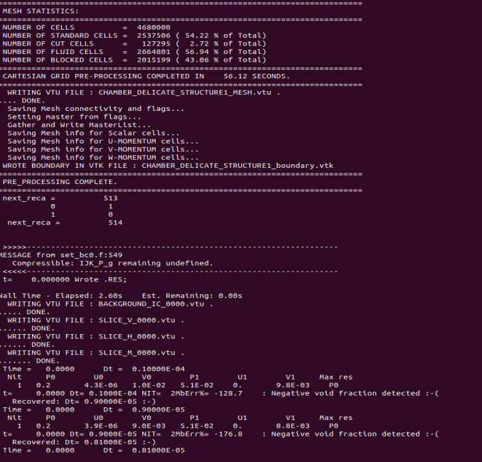

But when I switched to the computing cluster, the project will freeze and fail upon “computing interpolation factors in v-momentum cells” with “Bus error (core dumped)” with either “OMP_NUM_THREADS=16 mfixsolver -c -f chamber_delicate_structure2_clean.mfx” or “mfixsolver -c -f chamber_delicate_structure2_clean.mfx”.
This is the snapshot of .LOG after failure under computing cluster.

Hi Ju. It looks like this job is using a lot of RAM until it runs out and is killed by the OS.
At the beginning of the run, the solver prints:
Memory required: 9.00 Mb
but this is far from the truth! (We should probably disable this message if we can’t print an accurate estimate).
In fact the job ran until it used up all the available RAM on my system - 16GB. Here’s a snapshot of the memory used by the solver, as reported by ps -o rss=, in units of MB. After 100s the solver was killed.
This is a simple serial run, but it won’t get any better using SMP. With DMP the job will be split over multiple nodes, so the memory usage per node is lower, but I suspect you are probably running out of RAM on the computing cluster too.
