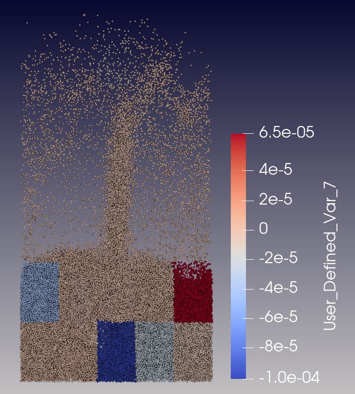

Hi everyone. Recently i’m simulating a fluidized bed and the case was ran with DMP(NODESI=5 NODESJ=10 NODESK=1), i tried to use des_usr_var in des_thermo_cond_mod.f and get the value of the conduction heat transfer (Q_pp and Q_pfp),but it’s failed, because the values were averaged by the processors, how can I deal with this question?
The first index of des_usr_var is the variable ID, the second index is the particle ID. Here you are looking a conduction between particle I and J, so my guess is it should be:
des_usr_var(6,I) = Q_pp
des_usr_var(7,I) = Q_pfp
otherwise you are constantly filling up values for all particles in a given process. This is why you see blocks of likewise colored particles. This must also considerably slow down the simulation.
